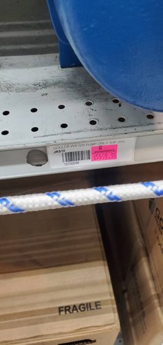

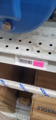

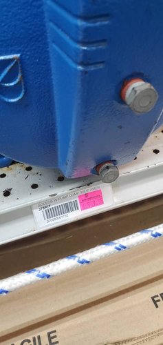

Allyuh ever price goulds pumps recently
..holy fuq

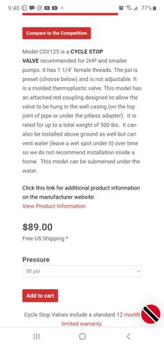

Btw where sells cycle stop valves locally?

they used to carry it,
guess you have to go amazon or ebay or the website
regular pump places wouldnt be so knowledgeable.

Postby pugboy » December 14th, 2022, 7:34 pm
https://www.ebay.com/itm/285002953390?e ... R8635K-iYQ
look like the company not selling on amazon
used to be $65, gone up plenty

I had posted 2 pages ago for you guys current Goulds prices:

j5s is the big boy goulds 1/2
used to be around $1800-2200
and the smaller jrs around $1400

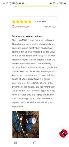

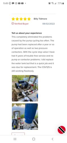

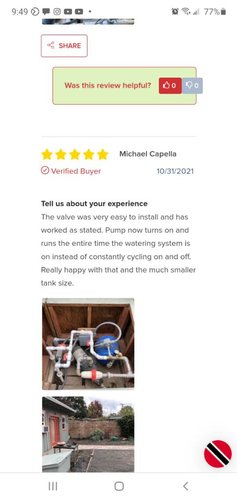

And pressure with that cycle stop valve. Prices I seeing are 150 us all the way to 300 usd.
Realistically if it saves you from buying a bigger pressure tank and also makes your pump last longer and also saves electricity....it should pay for itself quickly.....especially if paying for commercial current.
I plug in a smart plug with kwh reader this morning on a pump that giving me issues to see what the actual current draw is like
In like 1 min I hear it cycle on and off 4 times.

Postby pugboy » December 15th, 2022, 6:14 am
actually the mfg website has it for $89 free shipping
I use this one
https://cyclestopvalves.com/products/cs ... stop-valve
no need for the stainless.

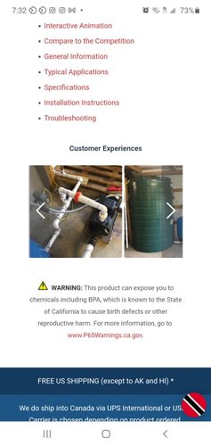

This bpa thing is genuinely a concern?
Or thats something that in everything and only the hippies worry about it
Posts: 29332
Re: Water pump
Postby pugboy » December 15th, 2022, 7:49 am
only if water sitting in a bpa plastic container long enough to absorb any in a certain quantity
vs passing through
we likely consume food daily that has passed through other similar chemical warnings on a daily basis
not to mention the air pollution and the testicular cancer risk of a phone in pants pocket.....
Re: Water pump
Postby maj. tom » December 15th, 2022, 8:53 am
The Rotoplastics water tanks safe regarding that so don't worry.
I never read of any concern of BPA with a water pump.

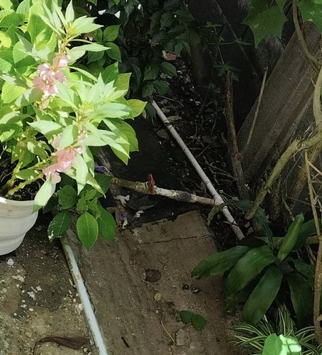

Dunno if my experience will help...
The photo showing the wasa main feed going to tanks at right, against wall. The left line goes across to house and kitchen(also connected to the line coming from the water pump), and that piece across the drain is a connection with check valve and lock off. Before I never used wasa feed direct, everything went to and came from the tank and pump system but in times when current went, open the lock off and use wasa pressure.
I started to open the lock off and leave it after one night of no current, then noticed sometimes water pump not coming on. I too thought it was the pressure switch (pump less than 3months old) but afterwards I closed lock off and never had any problems. The experienced men here will know better, but I thinking when the line pressure equalised with the pump psi or whatever, the pump wasn't activating.
