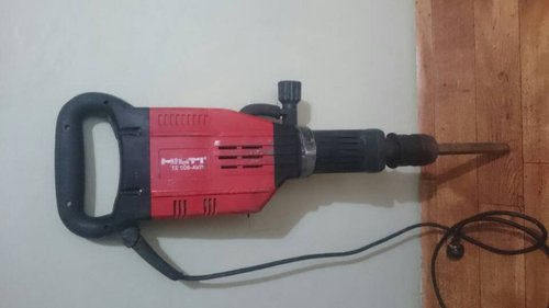

Postby NappyheadRR » October 12th, 2016, 5:44 pm
Hilti AVR TE 905 jackhammer. 7000neg. Inbox me for details.
