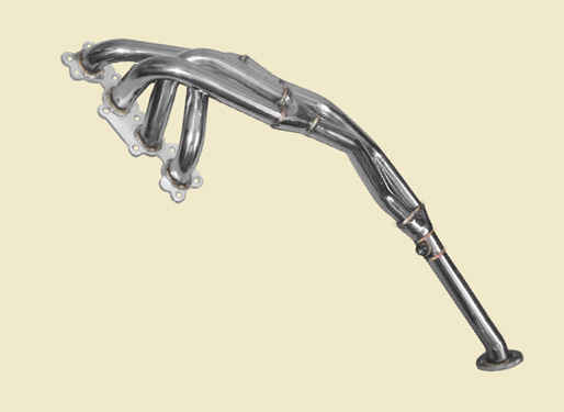

venum wrote:AWOL
how long the 2 pipes run?
till the firewall or two pipes and 2 exhaust barrel :?:
AFAIK it runs to the firewall or even under the engine an then is 2" or 2.5" pipe out...
I feel u'd loose compression if it's separated like that...our lil 1.5 not puttin out the kind power those V6 an V8 does put out 8-)
it should look somting like this..>>
venum
3NE2NR Diesel Boyz
Posts: 6001
Location: San Fernando
Re: CS Lancer!
Postby venum » June 28th, 2010, 10:55 am
yeah
that is why i was asking yuh
till firewall or a lil beyond that will be great
any further will cause a loss of power
before the firewall will cause a decrease in power output
