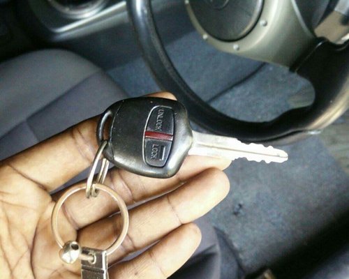

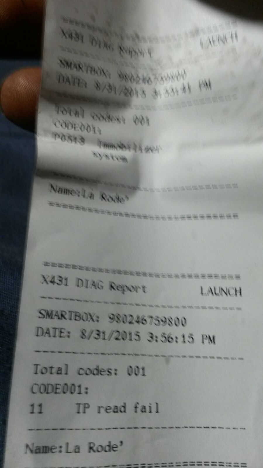

have an issue. The car refuses to start... It tumbles on a good battery. I got only one key with the car, so im not sure what gives. We ran a scan and got this print out: We didn't change anything. Immobilizer hard fault. No fault code for crank angle sensor.
Top code from engine control unit.
Bottom code from immobilizer control unit.
oh its a 2005 RallArt CS. 4G63 Non Turbo. IF that helps.

Banzai you mind writing the codes, kar see to good nah
I seeing po513 which is fault code for immobilizer key.
Never experienced this on a cs before but on a toyota yes. On toyota the car wouldn't not start at all, not even tumble. This was solved by having a new chip key re programmed to pcm. But it depends on if your fault is with the key or the unit
Could by-pass/disable immobilizer to see if this is your only problem and take it from there
Re: The Official CS Lancer Thread!
Postby Monk BANzai » September 1st, 2015, 1:37 pm
Yeah it's PO513. From all indicating it looks like I have to get a new key and get it programmed. Does the guy in curepe do such jobs?

BANzai Rastafarai wrote:Yeah it's PO513. From all indicating it looks like I have to get a new key and get it programmed. Does the guy in curepe do such jobs?
A new key programmed is between 1200- 1500 depends on model of car and type of key they using.
I did mine at JEL Enterprises in valpark 645-9535. This is the only branch that does it.
Theres a guy somewhere around uwi but i never got a contact for him.

Postby Monk BANzai » September 5th, 2015, 1:13 pm
This is the key. I'm seeing normal transponder keys with no lock/unlock buttons. But not this one. I'm also seeing shells with no transponders.
$1250 for keys at Jel Enterprises... $650 if you have your own dummy keys... I want two but prefer to spend $1300 as opposed to $2500... Esp as the dummy keys cost like $14 US for a pair.
