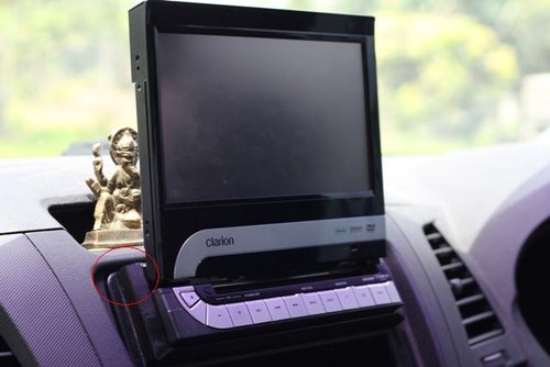

3) took a pic of the headunit in the vehicle.............finally

looking good.....one question though, why not install the H/U in the space underneath where it is now? if it were me I would have done that so that the screen would not be that high and so look a lil bit more stealth.....just a thought.
Firewall
Posts: 1287
Joined: October 29th, 2006, 8:15 am
Re: Toyota Hilux - JBL
Postby Firewall » June 5th, 2011, 11:42 pm
~Vēġó~ wrote:looking good.....one question though, why not install the H/U in the space underneath where it is now? if it were me I would have done that so that the screen would not be that high and so look a lil bit more stealth.....just a thought.

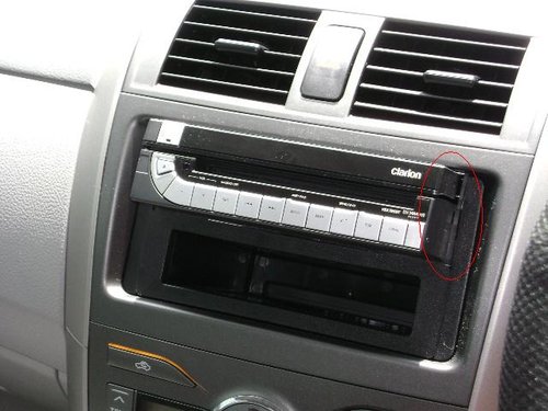

was done that way for a couple reasons:
1) the headunit itself protrudes from the dash by about 1.25" (that is apparently how it is designed to allow for screen clearance) so if it were mounted lower it would stick out like a sore thumb.
2) when the screen opens it would block access to the pocket, also if anything protrudes from the pocket and the screen opens accidentally the gears could be damaged.
3) the screen is not open for 99.5% of the time and with the screen down it looks stock"ish"
if you compare the pics with it installed in the car you would see that it looks really awkward how it sticks out, but in the van i cut a finisher from a pioneer deck to just "break up" the space and give it a more discreet appearance which allows it to flow a little better into the top of the dash. if mounted in the lower slot there would be nothing to "blend" it with
