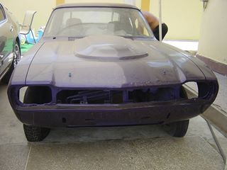

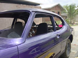

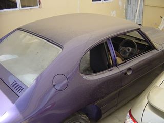

The Arrival.....
YES ITS A 1970 MK1 CAPRI

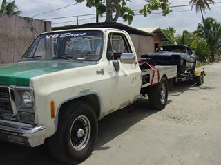

And just in case some Monster guys are lookin on....

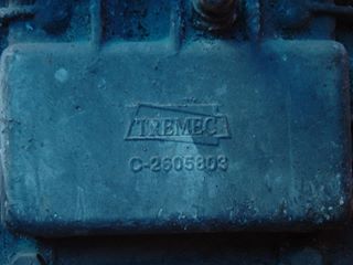

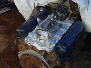

Pictures of the motor and gearbox soon to follow...It's a Ford 302 HO w/5spd Tremec short throw gearbox. Rear end is a Ford LSD 9".

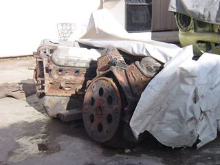

ACTUALLY, a few months ago...I was talkin to Kerry, DWO...and told him I was going to build a V8 to give him some compee...he chuckled as ALL good TRUE car guys do..and I then told him I'd like for him to "test drive" it for me....KERRY is one of the few guys I'd let drive any of my cars...he's not only a good driver/drifter but a good guy as well.
As for the power plant..I am going with the '86 model Ford 302 HO, as it comes with a good mid-section....hydraulic roller lifter engines along with roller rockers produce that effortless high rpm you need for a tail-happy drift car.
The 351 would be too heavy and wouldn't rev unless I stroked it.
Which I probably will do with the 302.

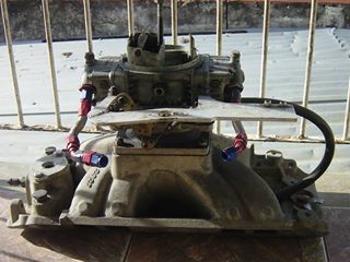

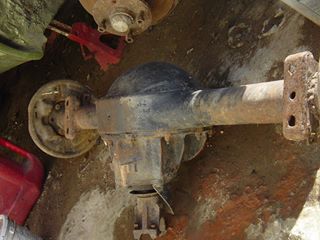

Pics below are of a 302, 350 and a 351, a 9" diff, and the Tremec.

Where can I score a diff like that?

sound boy 64 wrote:Where can I score a diff like that?
I have a Ford 8.8 LSD...$3000. ph 770 7791

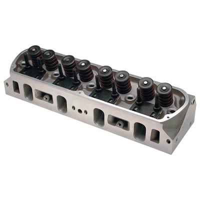

A pair of AFRs should do nicely....205cc....and I've always loved the easy 9000rpm a Ford Motorsport B303 cam gives me.

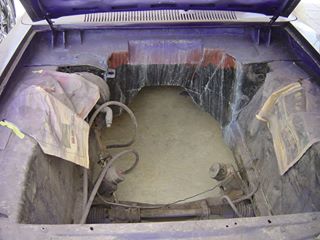

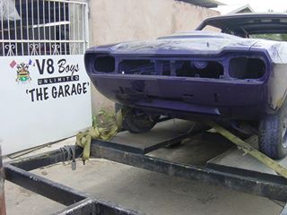

A few more pics... We'll be putting her up on stands by this evening and begin to tear down the suspension...make some polyeurathane bushings by Helmet, or Zigs, and start to reinforce the underbody with some sub-frame connectors etc.
ENGINE BAY ALREADY NICELY CUT TO ACCOMODATE THE V8, WE'LL BE DRESSING IT UP A LIL NICER SOON.
