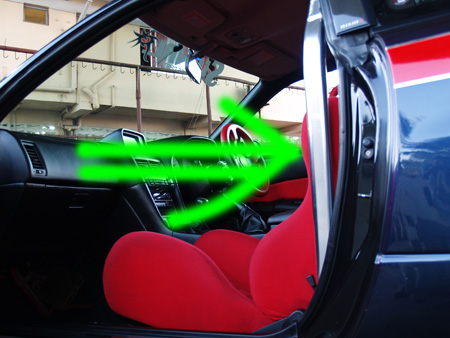

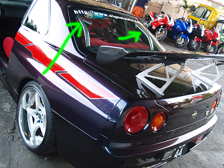

Presley's 714whp Signal R34 SV Skyline:
So I know Presley will have no trouble racing. If the fellas in Japan think it's needed in a 700hp Skyline... well, who is we?

But he did buy the car like that, it came with the cage, as seen fit by Signal Auto Japan.
Perhaps we can ask for a rulebend/bligh for cars that are just barely into 12s to not have the cage?
