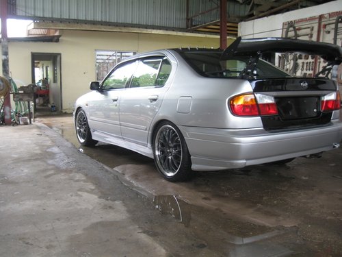

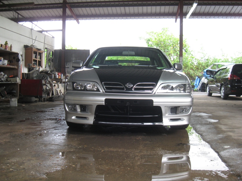

here's my ride, engine stock for now (still gathering money for sum mods) its a t-ev model but cant seem to relocate a back bumper
