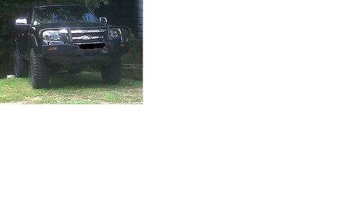

Aim: Increase cooling efficiency of Intercooler, radiator and A/C condenser
Vehicle: Ford Ranger PK 2.5 WLT
Basically i am looking to force more air over my:
- A/C condenser to increase cooling efficiency when parked in midday sun
- Radiator to aid in engine cooling
- Intercooler to get more dense air into the engine.
The issue
i have an ironman front bumper which reverts some of the air away from the front and reduces the room to play with.
The plan
Change the intercooler for a mishimoto Z line one and smoothen out the piping to reduce lag and turbo response. location??????????
Remove the clutch fan firstly, then, place 2 slim line fans either in the front of the A/C condenser pushing or behind the rad pulling air. i want to avoid changing the rad.
Location of the intercooler is the issue
Top mount with bonnet intake?
remove front grill and place intercooler up front?
all ideas welcomed

found ur problem..
The issue
lol jk, but the best place to put the IC is in front... less headache wrt to piping and less potential loss in boost pressure.

welll.....trying not to change the front bumper
Anyone have experience with slim fans used for cars on trucks?? im guessing water crossings might be a problem
A top mount intercooler may lead to heat soak when not running or going through mud.

Postby lighthammer » September 19th, 2012, 1:09 am
Yup. correct on both counts.
That's one of the problems about these steel bumpers - a lot of the cooling gets blocked off.
Not much else you can do there dude.... definitely move the IC a lil higher though, should have space for it.
