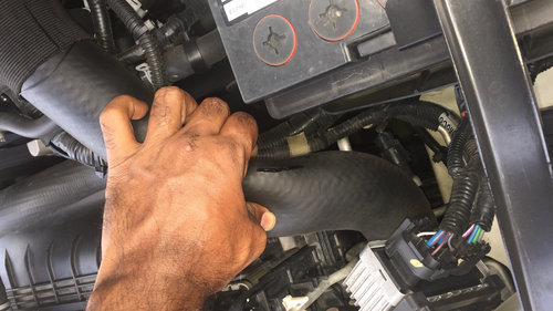

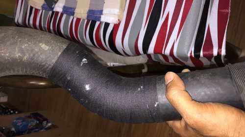

So coming home from mt hope Friday morning at
4am,heading central,nice clear road,cool air.
Near bird sanctuary I decided to tip the x a bit on the ranger 3.2.
As soon as I did drivetrain light came on and van went to limp mode.
I drove home and switched off,next day started van and error was gone but van seemed a little lazy driving in back roads by me.
So I started checking the simple stuff first,fluids,belts,etc.
Found this.
Had to do a temp repair with silicone and some
Twine
kamakazi
Posts: 2931
Re: Tech Thread - Ford Ranger
Postby kamakazi » April 19th, 2017, 10:47 am
To much boost....
