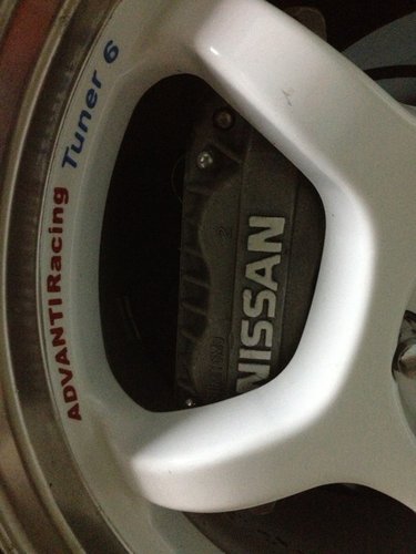

i got the ADV22F on a B14 and would like to get steel braided lines for the setup. do i buy the same B14 brake lines are the fittings the same?
http://performance.importrp.com/goodrid ... 97638.aspx
anyone got part numbers for any good brake pads for the ADV22F brake set up?

yakuza
Posts: 954
Joined: June 13th, 2007, 1:46 pm
Re: SIMPLE BRAKE UPGRADES
Postby yakuza » September 28th, 2014, 2:04 pm
Stick to something of OEM quality, I don't recommend green stuff for a daily driver, the pads ware in no time and they are not forgiving on rotors.
Some brands you can check out are Hawk or PBR AXXIS.
Postby ruff neck chicken » September 29th, 2014, 2:01 am
my setup might need more than the AD22VF but that is just more weight so i'm just trying to maximize what i can get out of these. good rotors, pads, steel braided lines for now.
Postby THE SYNDICATE » October 2nd, 2014, 8:02 pm
This is what I upgraded to from the ad18v's.
