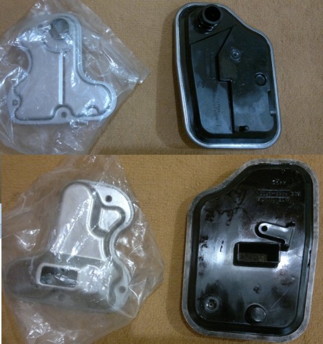

Average
Posts: 763
Re: MAzda 323 Automatic transmission thread
Postby Average » August 31st, 2013, 10:44 am
:!: As ah see this thread.....did the change and just for info purposes, the filter on the left does NOT work on 2003 BJ's.
If anyone doing a change and their car uses the one on the left, feel free to PM me...$140.00 (still in packaging)
Wildcard26
Posts: 1122
Joined: January 14th, 2009, 8:29 pm
Postby Wildcard26 » August 31st, 2013, 12:41 pm
Average wrote::!: As ah see this thread.....did the change and just for info purposes, the filter on the left does NOT work on 2003 BJ's.
Filter on the right is what my 2002 used as well...Folks the Filter on the right is what 01-03 BJ uses. I am not aware of what the 98-00 uses though so maybe some one can chime in to verify.
Postby cinco » September 1st, 2013, 7:10 pm
isnt it all the same tranny from 99-03?
the one on the left is probably for a bh or bg 323
