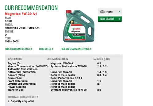

Postby crotch rocket » December 19th, 2012, 12:39 pm
I use this in my hilux.. sorry but pic rotated for itself...
equipped2ripp
Posts: 4983
Re: What oil u using in ur diesel van?
Postby equipped2ripp » December 19th, 2012, 12:58 pm
where did you get it?
sliderz1
Posts: 7153
Postby sliderz1 » December 19th, 2012, 2:02 pm
more curious at the price of the thing

crotch rocket wrote:I use this in my hilux.. sorry but pic rotated for itself...
The dealership here suggested I use this oil also. I don't mind using the Toyota oil, but wouldn't it be a good idea to use something heavier like a 15w40 on an older engine? (2007 model with 88k on the clock).
