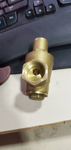

welll..... i guess not. I was there buying the pump so i had picked this up one time, rather than making a next run in that traffic for a plug. Check Modern Electrical they bound to have it cheaper.

make sure and install the pressure regulator in place easy to access and with unions so you can just swap it out
and if you feeling fancy install a bypass so you can lock it off and have wasa feeding house in case it need servicing
also install pressure gauges before and after so you can see the difference
the cheaper ones sometimes wear out on the valve seat

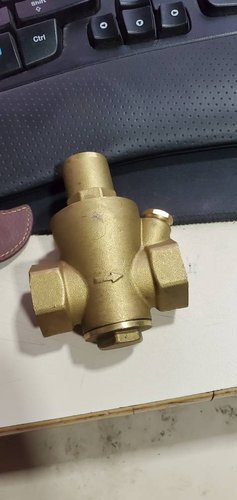

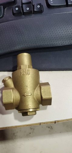

this one was 400 and the quality looking and feeling bess
i putting it after a 1hp pump to dampen the pressure

my issue is that the plumbing in the building old and need changing
not able to do that right now so rather the pressure be regulated to a lil 45-50 psi

the only issue with that small regulator may be how much gpm it allows
if somebody else taking a shower you may reach a bottle neck in gpm allowed thru it to hose the yard or such
