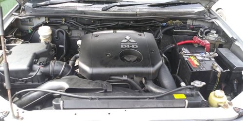

Good day. I'm new to the Mitsubishi/Triton scene as I was recently gifted the vehicle.
It seems to be in fairly good condition however I have noticed two issues.
1. The engine has a "rattle" which seems to be the lifters/ rockers/ tappets. The engine is 4m41 engine 3.2L. How do I go about sourcing those parts and preparing?
2. At speeds on the highway, the steering has a noticeable kind of knocking feeling. It isn't the wheels (they are well balanced) or the steering ends as they were replaced with OEM parts about 4 months before I got the vehicle. Any suggestions?
Thanks

Good day and welcome to the club. You've made an excellent choice.
The 4M41 has a chain driven valvetrain and as such, the chain is significantly louder than the 4D56 which is belt driven. You can visit Dr. B's in Marabella to have it checked and serviced.
As for the steering knock, the 4M41 is a much heavier engine than the 4D56 but uses the same suspension and steering components. As a result, additional and premature wear occurs on these parts. That knock could come from the bushings and clamps associated with the steering rack.
Send me a WhatsApp at 349-4213 and I will direct you to the 2 mechanics who will sort the respective issues
