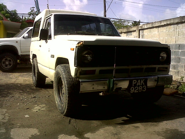

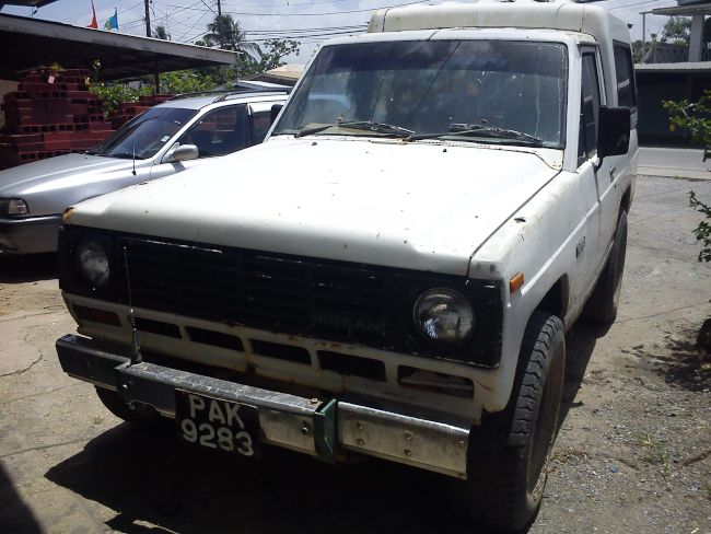

right, so i recently bought a short wheel base (SWB) Nissan Patrol, now i like mih toyota bad ehh, but i like to try different menus to, cant eat the same thing everyday....
its a 1983 Nissan Patrol with a SD33 inline 6-cylinder diesel engine, has a 4-fwd 4wd gearbox and is solid axled and leaf sprung front and back.....which is one of my main reasons for buying this van, and its legally registered for 8 including the driver, cud wukk taxi in paramin boi!!!!

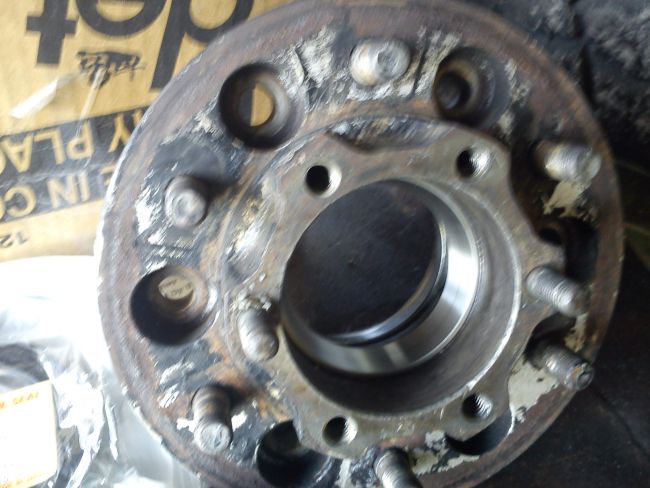

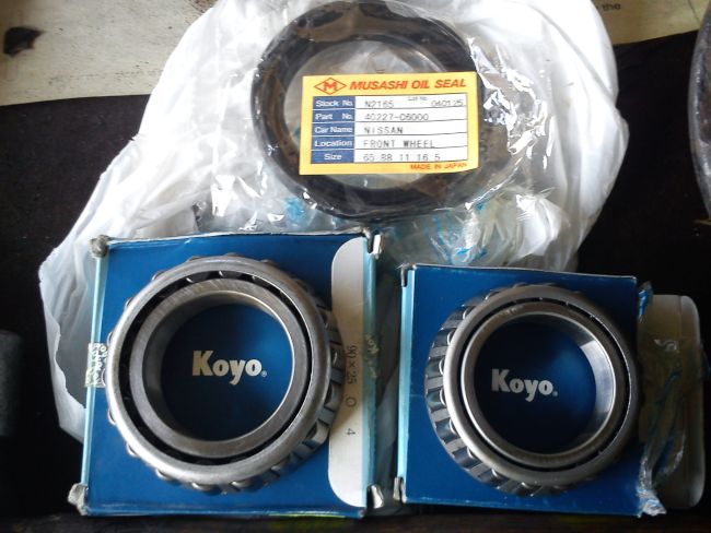

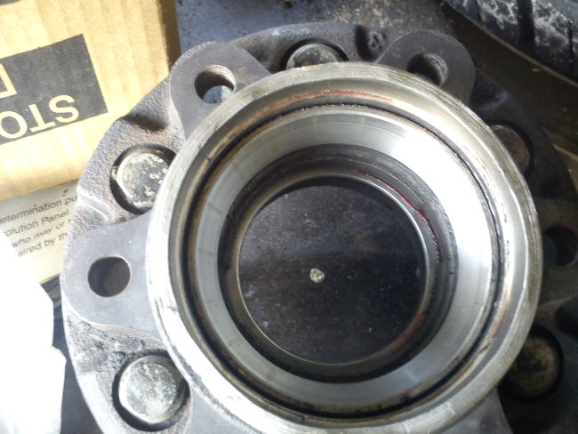

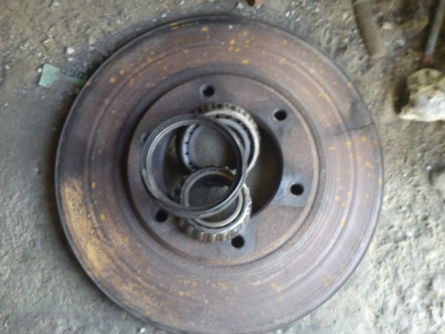

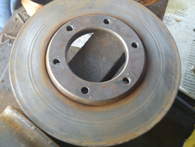

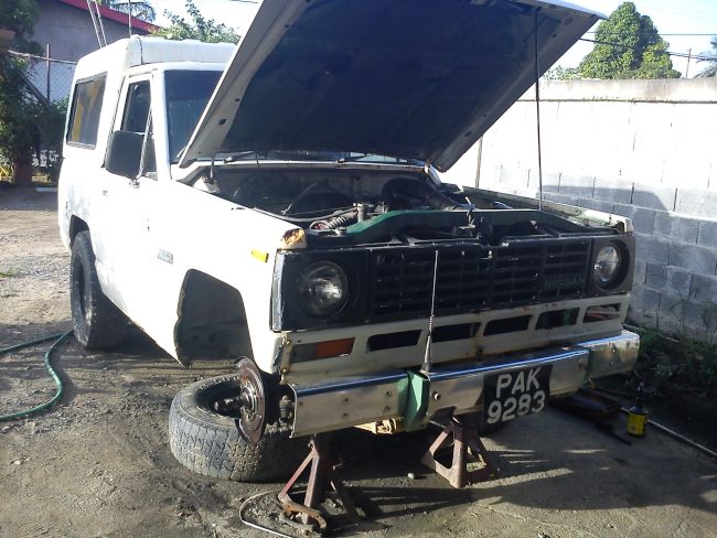

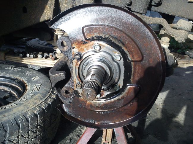

when i got her, it was starting and driving, but had a severe pull to the right, upon inspection i realised the right side rotor disc was cracked and the bearings were bad, so this was the first task at hand.........
i journeyed down to san francique by a guy called electric where i got a used rotor in good condition, then went up by roach in puna and got both bearings and the seal, then i changed out the rotor disc, races and bearings, with mounted back up with new disc pads, bled brakes and was time to try the 4wd........how yuh mean, yuh go buy van and eh know how it wukkin!!!!!!!!!!!

what it looks like
what i wish it looked like
the culprits, bearings, seal and rotor disc...........
the replacements...
the front end jacked up to work on the brakes......
clean shaft!!!!!!!!

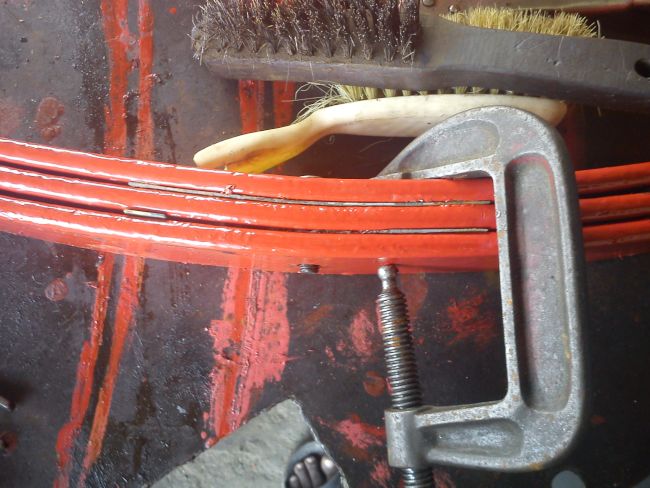

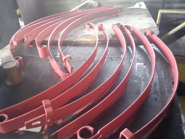

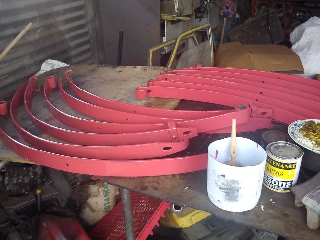

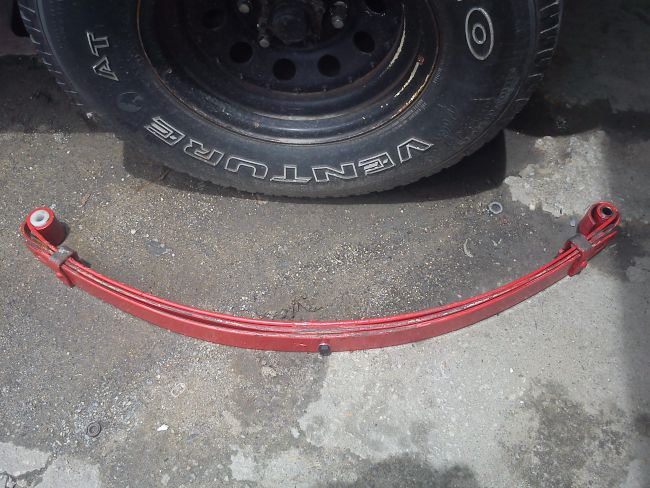

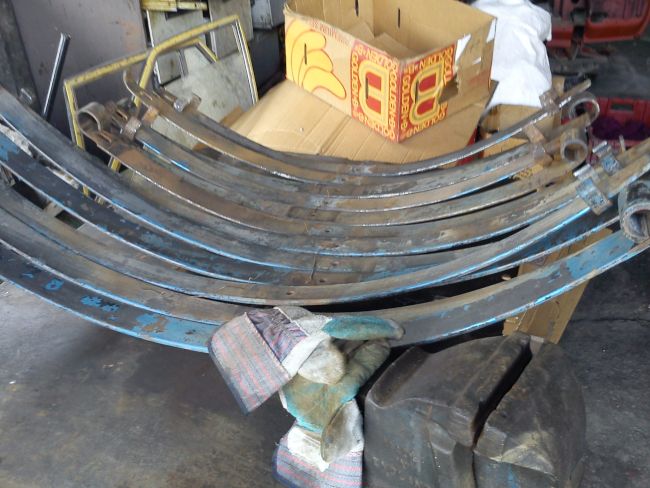

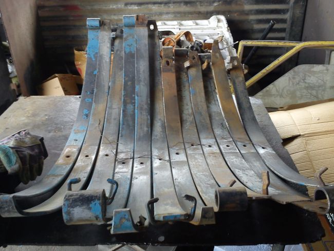

so stage 1 on my lift series has started, i sent the springs to retension and got them back looking very curvy, clean and painted them too, will post those pics, tomoro im going to help the machinist make the bushings, still looking for the correct king bolts!!!!

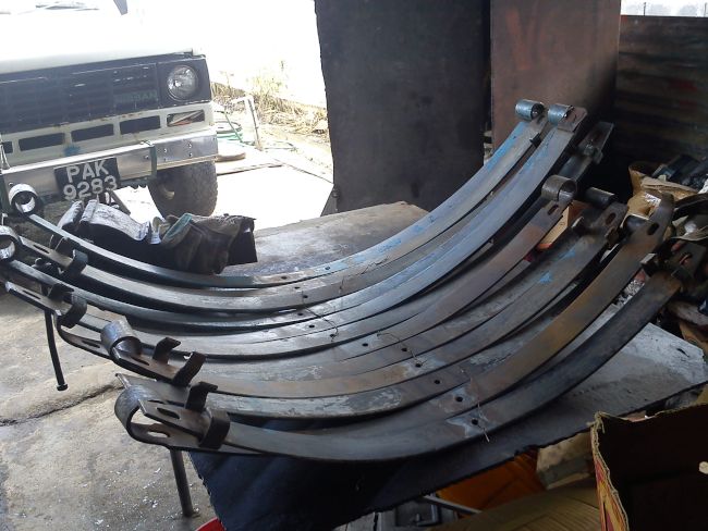

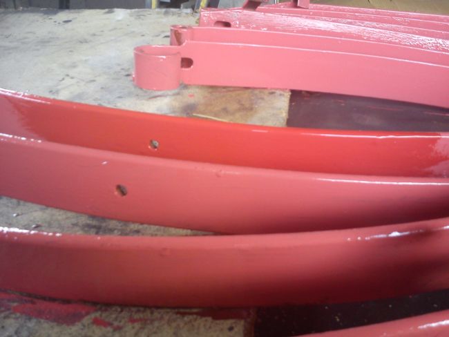

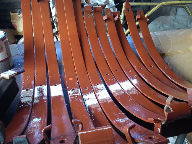

when i got back the springs i gave them a good clean down and wire brushed them out....
they look more nice and curvy now, before they looked kinda flatish, hope the end result is favorable.....
after cleaning them i applied some red oxide primer......

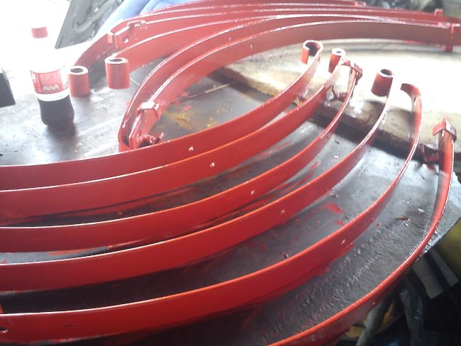

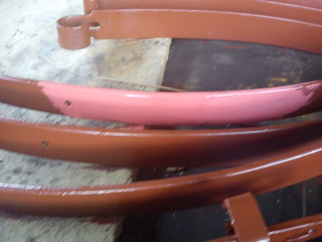

then was time for paint, so i mixed up some red and white chinese laquer i had sitting there......
end up with this rel bad panty pink colour......
i said nah boi, dat cant work, even my nephew was laffin his ass of, he say nice color for the mud man...

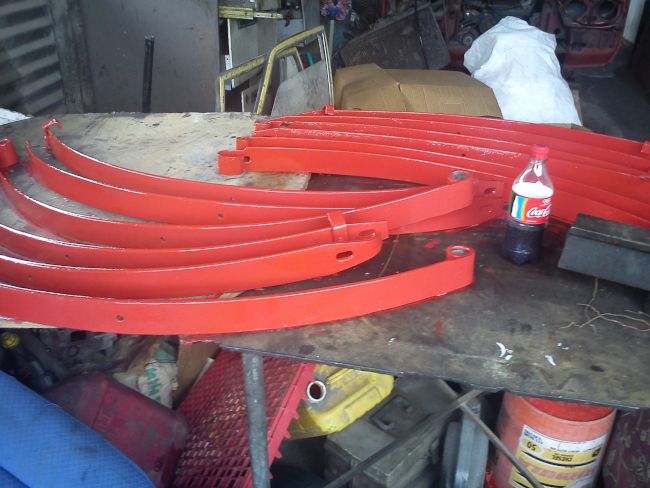

so i end up just using the straight red on it.....
still wanted a brighter red colour, but thats gonna have to work for now.....
have to clean the U-bolts, plates, hackles, and free up the grease-able pins, and then paint them too....

what type of spring are those?
how did your go about re tensioning and increasing curvature?

D man building another beast....Side B will B full of them just now...
He had them pressed....

@ neckto, i wasnt there when they were being done, but as much as i was told they were cold pressed on hydraulic bender, they took a good shape and over tensioning them cud lead to them breaking or making the ride even harsher........

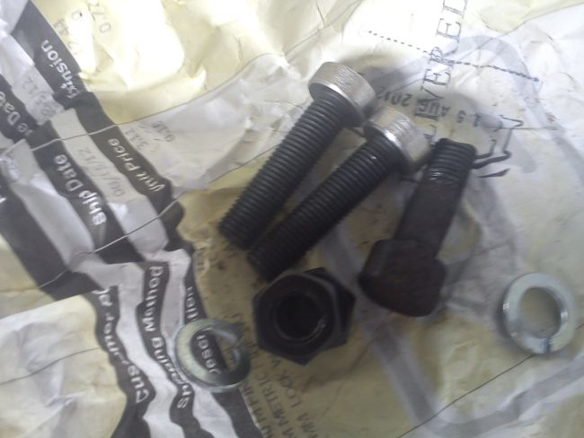

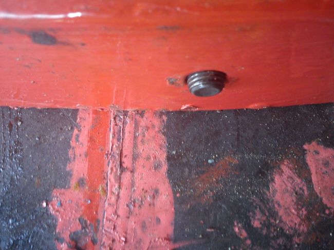

so made a couple of to and fros, getting measurements and what not and laising with the machinist to see what best works.....i bought some king bolts. but 3/8s were too small and 1/2" was too big and i cudnt get 7/16 which was the correct size of the bore in the spring centre, so i bought some 7/16s bolts and had my boy turn off the heads so they would fit into the diffs......

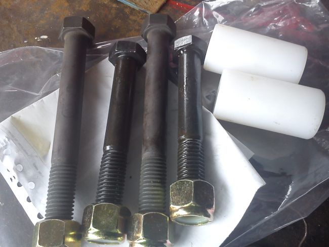

also i bought some 5/8s bolts for the rear shackles, as the current ones are a bit rusty, and odd sized, so these bolts with the uhm bushings and we good to go!!!
here is one of the front bundle done assembled and ready to mount up, both bushings done inside...
uhmakateflonakaplastic in the rear of the spring
full steel bushing in front of spring, thats how it is original, it also has greasables in front

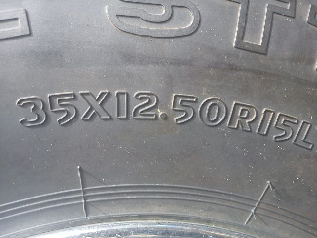

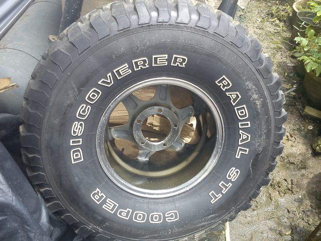

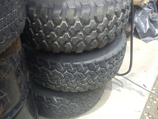

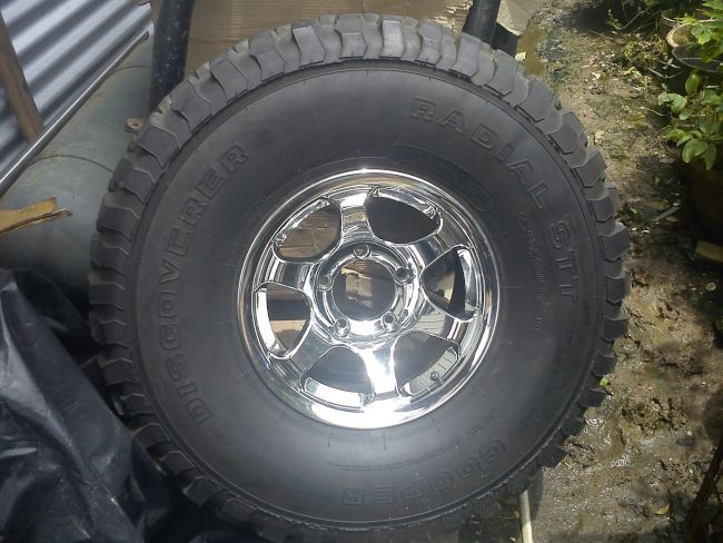

these are the tyres im hoping to run....

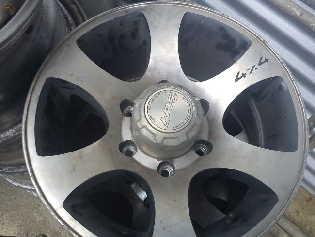

not the rims tho, those are zuki rims, 15X10s...
unfortunately its not the same four, its a pair of bfg AT and a pair of cooper STT, but that will work for now, most important they all the same size....

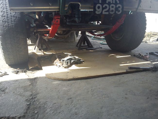

so the front went up. but didnt finishe up, U-bolts to go up still.......

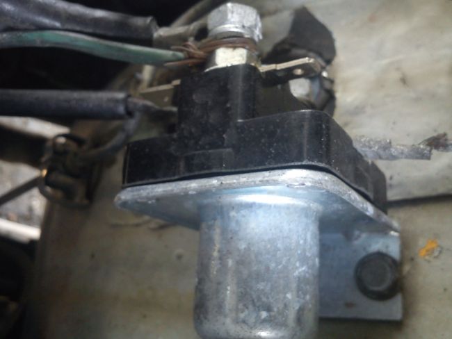

while we down, i changed out a static, so it starting better now....

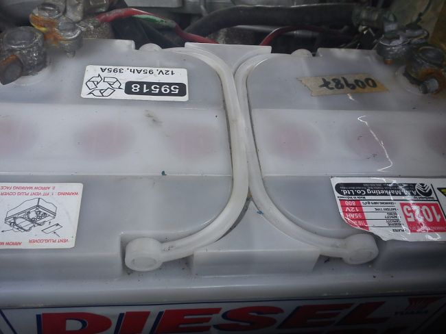

also throw in a new 17plate diesel power battery.....

so increasing the curvature wouldn't decrease the mounting distance of the spring to the chassis? did you have to move the mounting point on the chassis to accommodate?
droppa
Posts: 4191
Re: droppa's SWB Patrol
Postby droppa » August 17th, 2012, 12:51 pm
well it did make it a bit harder to mount cause the springs are a bit shorter now, hopefully that wont cause the shackles to invert.......did not move the mounting points, still the stock, but i have a mod for that coming up soon.....

Postby neckto » August 17th, 2012, 1:27 pm
OK cause if u looking at for the increased curvature to allow higher ride height as well, remounting in the stock positions might want to force the springs to flatten back out a bit.
