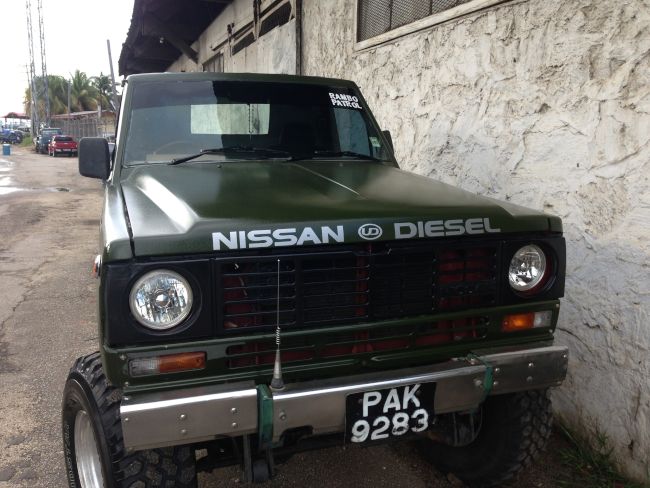

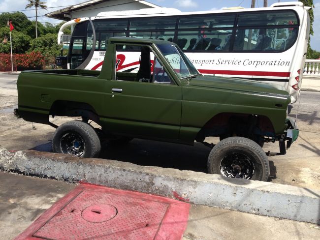

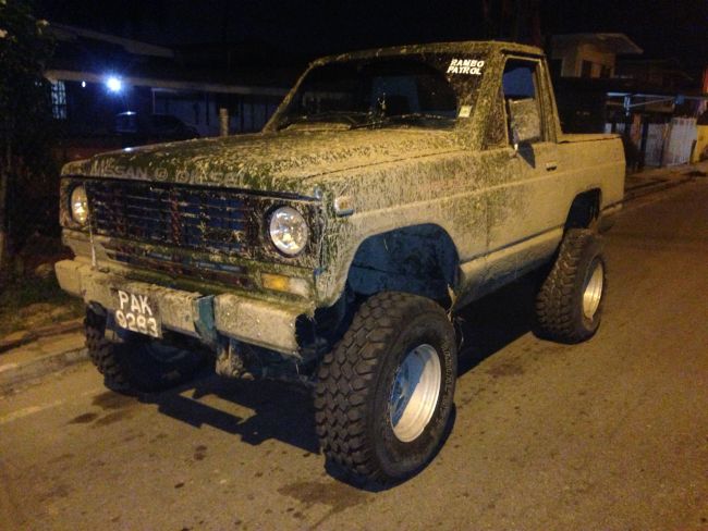

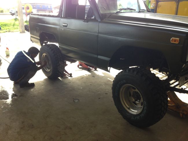

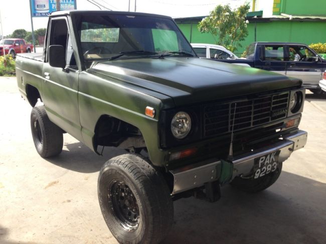

fresh out the paint room and getting some fuel......
after a brisk mount up, some lights and rubbers....

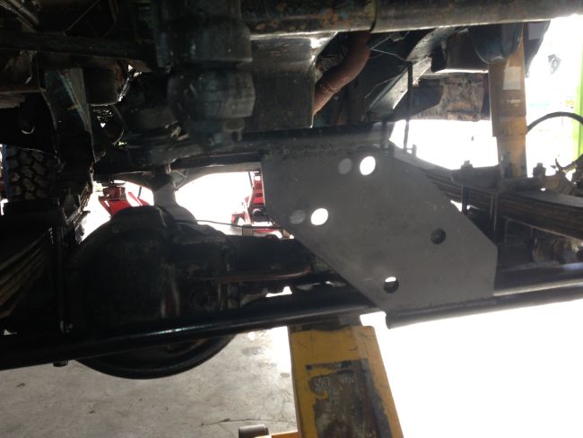

Captial Z bar for the SPOA
fitting the raguna lube 10" to some 33" mudstar rubber
must big up mih tyre man, great service everytime....

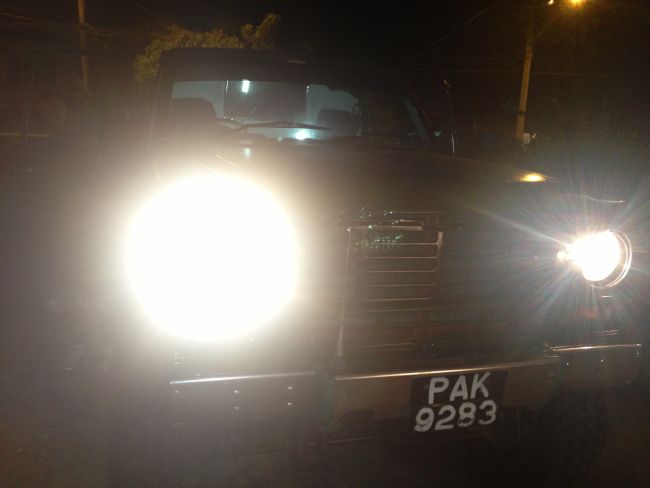

fitting some new bulbs, thanks to mih boi Hyper V Racing....
they bright like that and work great....

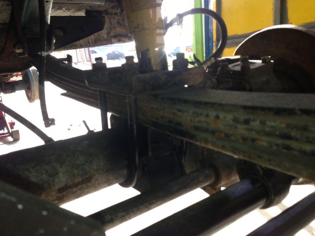

Aye Rene I did get the shackle sorted, we took off some tension from the rear leaves and the shackle is in a better position now, actually rides plenty better and not as much bounce, need to do some work on the bushings tho, they are being tightened into the spring and shackle and causing them not to flex, ill fix that soon

Yeah boi Pa, that green looking like hulk use more gamma rays than he expected...Lol...So yuh prime with gravitec and paint over that in d green? Why d 33" tho and not d 35" as before?
droppa
Posts: 4191
Re: droppa's SWB RamboPatrol "Painted & SPOA"
Postby droppa » July 2nd, 2013, 7:29 pm
Yeah we prime with sand and fill primer first then cover with the gravi then add the colour on that
Hearing that the gravi can be tinted to what ever colour u want, but that I have to find out more about
And well depend on how u mix, spray and number of coats determine the finish effects
As for 33s, it what was in stock, I didn't want it and still don't like it, it's too small, but she works a lot better, I will definitely have to regear at a later time

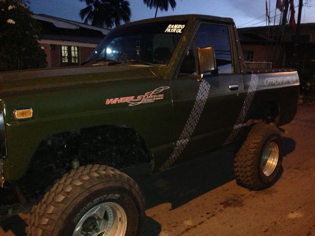

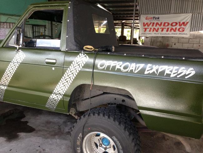

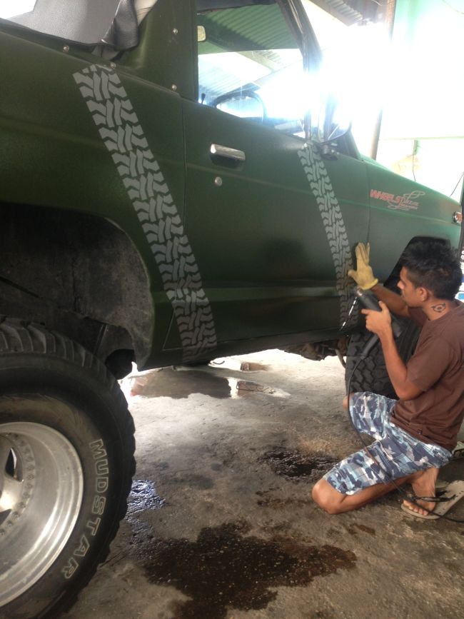

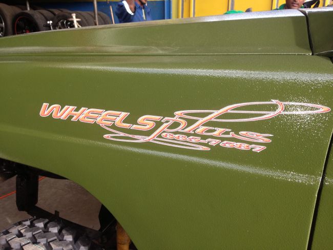

after i got my inspection done i went over to Unique Tint Shop to get some stickers.....

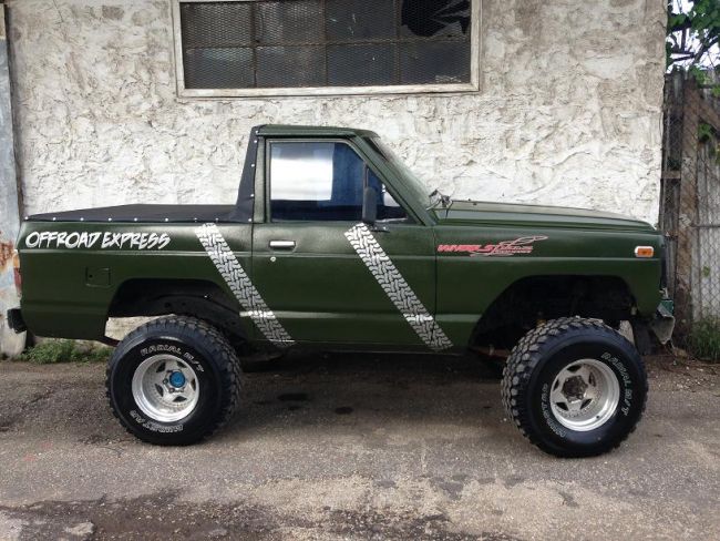

closest suitable tire tread we could find, it will work for now.....
Offroad Express is back............

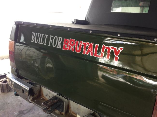

Built for Brutality....thats mine eh.........lol....
officially named
collected my inspection sticker this morning, ah bad till 2015 now......this UD logo, real win....
have a few more we working on, first vehicle i add so many stickers too, but i like it, turning heads of all ages, sex, size, shape and colour, and getting thumbs up and thing...just have me grinning....

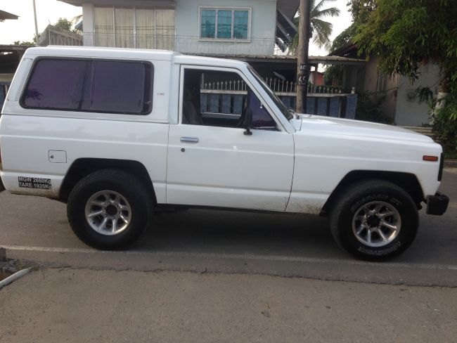

anyone intrested in a good working patrol for sale check me.......lol...ah serious....
heres the pics....

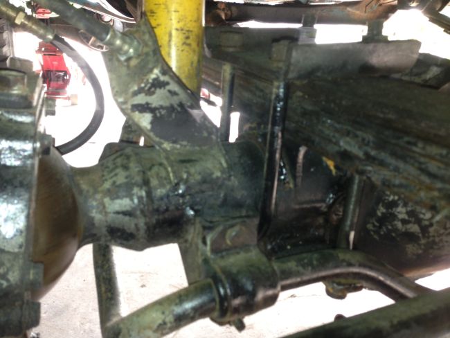

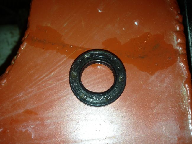

pressure take mih last week and the steering coupling pad burst, so had to make over in one of the toughest replacements to be found, conveyor belt....
had to get the carbon steel blade to cut it....
then after i mount that up the rear housing start to leak....
pulled out the housing and tried a shortcut...
coverd up and done for today....
the lil fella that causing the disruption in society....
got the new seal at kawal singhs and had to take down the entire box and got it fixed outside, mounted back up and good to go again.....

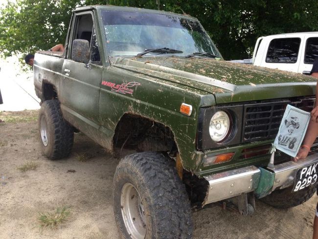

on the cedros run had a lil hiccup where my right front wheel bearing ran slack, so we get master wabindranath........lol, to fix it up....
on the run.....
after the trail, home in one...
