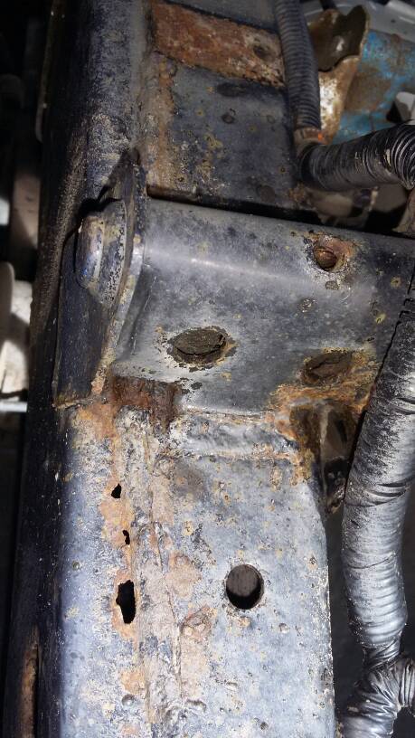

disappointed. all my mup to date maintenance on the d4d and now realise chassis rotted
Re: Tech Thread - Toyota Hilux...D4D and all older models.
Postby Ted_v2 » July 21st, 2015, 2:08 pm
Front below the rad?
Team Loco
Posts: 5297
Location: Trinidad y Tobago
Postby Team Loco » July 21st, 2015, 10:14 pm
Below rad yes. But around rear shock mounts its also rotted
Postby Ted_v2 » July 22nd, 2015, 12:54 am
Yikes. Get that sorted out and undercoated
