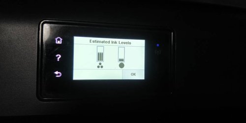

Take a look at these pics ppl. Bought from psmart and tried printing in both black and white and coloured and the pages came out blank. Ran a test page and it printed coloured AND visible. Any ideas why ? Change printer brand ???

But you need to buy new ink. The cartridges that came with the new printer are just demos, and not filled all the way like new ones. And that reading may not be accurate. A new cartridge will calibrate the printer head properly to the filled levels of a new cartridge. You also need all 4 inks CMYK to print properly, even regular black and white because they mix the create richer and darker blacks, and also print invisible secret dots on each page as a unique marker (MIC), like this:

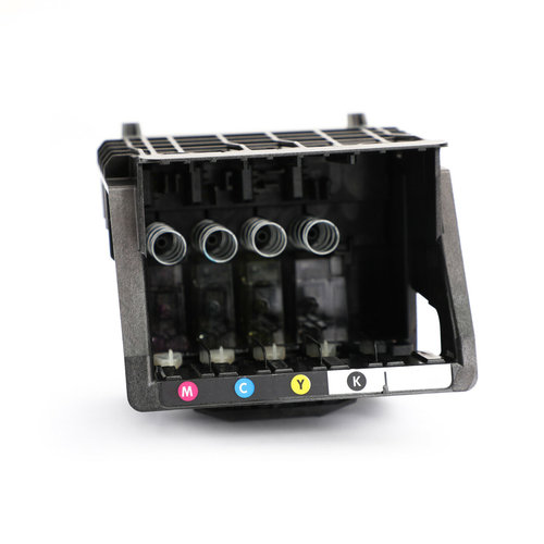

Make sure to clean the printhead which is the component the CMYK ink cartridges snaps into. If not in use for a while, the ink in the nozzle dries up and harden. You can use isopropyl alcohol.
Get this on a regular when Officejets are not in use for more than a month.

Thanks all. Printer and genuine ink bought from pricesmart. Cartridges replaced about a month ago and been used a couple times per week for kids school printing so not packed down for any significant period to allow drying .
Its the first time this happened with the levels showing so high tho so I wanna believe it may be that the nozzle may need cleaning as suggested.
Will give it a try when next I get a chance and update .

The read out on that particular printer and most printers in general is an estimate... It has no idea how much ink is remaining in the cartridge.
Printers deliberately use blue when printing black to use up ink faster in my opinion.
The setup cartridge for that printer in the past had more ink capacity than the cartridge you just bought from pricesmart.
