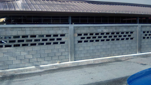

The factory gives the large hardwares a deal if the buy at certain times( when demand is low and production keeps running causing a glut). They have to buy $2m and remove it within a month, so the hardwares can sell below factory prices and still make a profit. Real Tuff and Bhags are among the ones that take advantage. So the price is almost the same but with concrete you use 3/4 the amount. If laid properly, a concrete wall is a thing of beauty.

Op, no need for plaster and paint.
