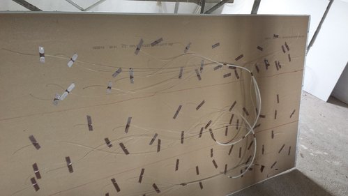

ziggy_dappa wrote:^^Thanks.
And if you are really adventurous you can DIY the light engine and spend the extra on more fibers :)
Parts can be easily found on Ebay.
Ziggy, how long did it take you to do that fiber ceiling as a diy?
ziggy_dappa
Posts: 236
Joined: April 8th, 2004, 9:49 pm
Location: Down de road...
Re: *** THE OFFICIAL HOME THEATER & AUDIO THREAD**
Postby ziggy_dappa » August 13th, 2015, 8:44 am
Longgggg........its alot of work !!!! But easy.
I spent about 3 hours every evening for about 4 day to complete it.
I had to mark and drill the gypsum sheets on the ground, set the fibers in place and then bundle them into individual groups do so I could pass them over each furring channel, when they applied the joint compound and sanded the ceiling alot of the fibers broke off and I had to pull them through with a fine bird beak pliers.
Alot of work but awesome end results.

ziggy_dappa wrote:Longgggg........its alot of work !!!! But easy.
Nice results after all that hard work. I must say that once we put alot of our effort into a HT project, the enjoyment factor is that much more than if it was done for us... Waddaya say dere chiney?
