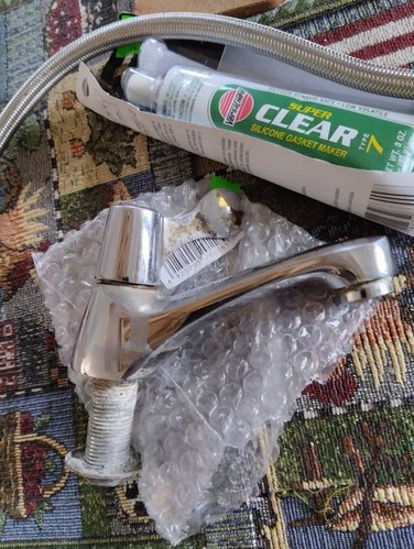

Just got a plumber to change some fixtures at apartment, and he said "doh throw way dem ting fellah it could fix back easy" so I kept one to try my hand at a DIY. I have no idea how to start, anybody have a clue how this opens?

Postby viedcht » April 11th, 2024, 10:37 am
Pic of the swing tap to DIY repair

Postby Dave » April 11th, 2024, 10:47 am
Top pops out with a flat edge...screw to remove and you will see the cartridge. Remove and see if you find one.

Postby viedcht » April 11th, 2024, 10:59 am
I think I eff this up already unless it was the problem.
Tenant just explained, the tap was swinging beyond the quarter turn stop point and water was leaking from the faucet outlet as well as the swing top if it wasn't centred.
Took out screw and the handle was just spinning not coming off. Done fling way that but maybe next time I'll try
