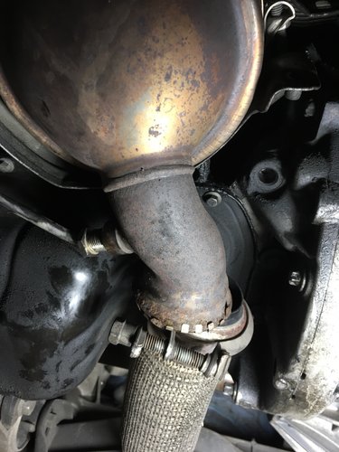

I decided not to go with the dpf-delete
I removed and cleaned it this weekend...life is good again

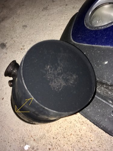

topshotta20 wrote:
MG Man wrote:cool
By who?
By me
Removed
Flushing it out with carb cleaner

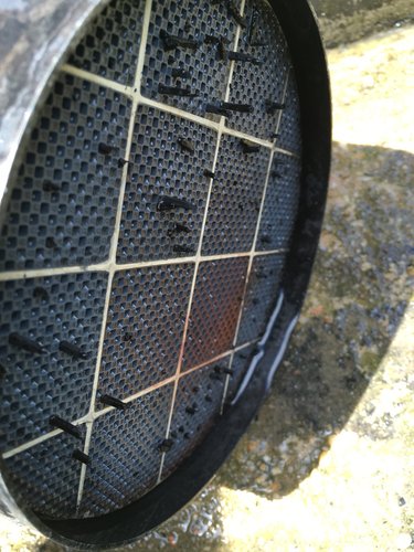

This rellll interesting hoss....
So the carbon comes out as little rods?
Re: DPF filter???
Postby adnj » October 3rd, 2018, 10:17 am
Highway driving is typically all you have to do. The soot just gets blown out in small clumps that are no longer airborne.
The filter is a package of tubes so you may get the rods. An air gun also helps if you have one.

*KRONIK* wrote:This rellll interesting hoss....
yeah
the filter as mentioned by adnj has narrow tubes so that's how the carbon is forced out
I started with a pressure washer and removed all the visible crud. Then sprayed healthy amounts of GumOut carb cleaner and repeated first with the pressure washer, and then with a jet nozzle on a a regular hose. I found the volume from the hose was more effective than the pressure washer because of an elbow at the closed end of the dpf which prevented a direct blast into the filter media from the pressure washer

Postby adnj » October 3rd, 2018, 12:49 pm
Get two plastic bowls where you can stand it up. Spray in some carburetor cleaner and let it set for five minutes.
Put it in the other bowl and pour the used cleaner in. Repeat a few times. You're really only trying to clean out the carbon deposits.
Use compressed air to blow it out if you can.

Posts: 23908
Re: DPF filter???
Postby MG Man » October 3rd, 2018, 1:57 pm
yeah
In my case, it took about four hours to remove it, and about six to reinstall it
but really, if you do enough highway runs, you won't have to go through all that drama because the regen cycle takes care of cleaning out the crap
