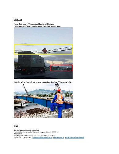

To my eye that looks like a high cube container. A high-cube container is 9.5 ft high vs. 8.5 ft for a standard. To make the maximum 13.5 ft vehicle height, it gets mounted on a low-profile trailer. A low-profile trailer has wheels that are smaller than the typical semi-tractor trailer.
It doesn't look like the driver did what he was supposed to do.

The reason they dont latch it is in case of an issue they dont want their trailers to capsize/twist and damage. They prefer the container just fall off

but wasn't the structure too low in the first place? It' was just a standard truck and trailer and container ..
Posts: 18929
Re: Interchange at Curepe - Churchill Roosevelt Highway/Southern Main Road flyover
Postby Dizzy28 » January 7th, 2020, 3:56 pm
VII wrote:but wasn't the structure too low in the first place? It' was just a standard truck and trailer and container ..
Given the importance of the CRH I'm sure other container trucks passed before and after (the truss was back up by this morning) that particular truck with no worries. Something had to be amiss with that truck and its height
Postby pete » January 8th, 2020, 8:04 am
Trailer does look a little tall and with the truck raised, the front of the trailer was probably just above the 4.5m (14.75ft) height restriction. Should've dropped it down to pass the two overhead obstructions. Structure did it's job though, better that get hit than the scaffolding in place below the overpass.

Postby rspann » January 8th, 2020, 7:27 pm
Everybody blaming the driver, but he didn't have a choice . They put the barrier in a place where there is no detour or any other option. They could have put it just after the opening where the no U-turn sign is so the truck would have an option to turn right and go back west. Probably pass on the main rd or through Kelly. The only choice he had was to reverse to Valsayn North second entrance. Try doing that with a trailer.
Anybody see how it was cut and welded back with short pieces of steel reinforcing the weld?

That span is to wide for that type of steel. Its starting to sag already and will get pull down if it doesn't fall first.
