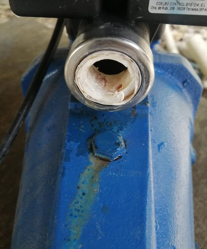

Fellas,
From trying to fix a drip-drip leak, I end up like this when I was unscrewing the adapter to add more tape. I had already had tape twice before and still the leak remained.
Anyway, what the best way to get this broken piece out without messing up the threads of the pump outlet? Thanks.
fokhan_96
Posts: 1820
Re: Building a house in Trinidad
Postby fokhan_96 » May 15th, 2024, 3:19 pm
Cut different areas with a hacksaw blade and use small chisel or flat head screw driver to prise off. Remove pieces with a small bird beak pliers.
Before you do anything make sure and place a piece of cloth on the inside in case any small pieces fall inside.
Posts: 20001
Postby Chimera » May 15th, 2024, 3:42 pm
Yup....hacksaw blade and slice it up
sotf
Posts: 140
Joined: May 18th, 2008, 9:15 pm
Postby sotf » May 15th, 2024, 3:46 pm
Used the hacksaw blade and then a putty knife like a big screwdriver to unscrew it. Thanks.
