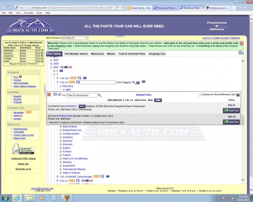

AE Part # MVB2013R6 Number of Ribs: 6; Length [mm]: 2013
Driven unit: alternator
2005 MAZDA 3 Belt
I searched this on rockauto for the belt....can anyone confirm if that's the part?

konartis, when I changed mine I used an oem from SS
6PK1864 Z601-15-909A

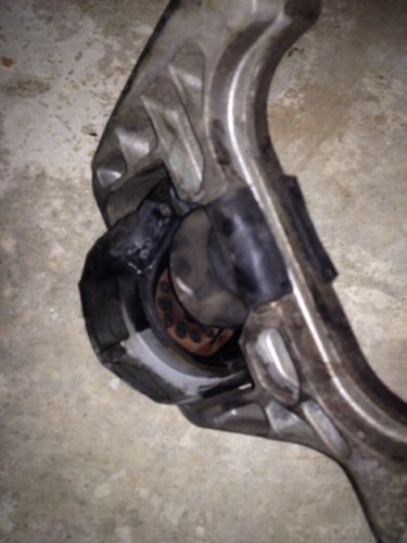

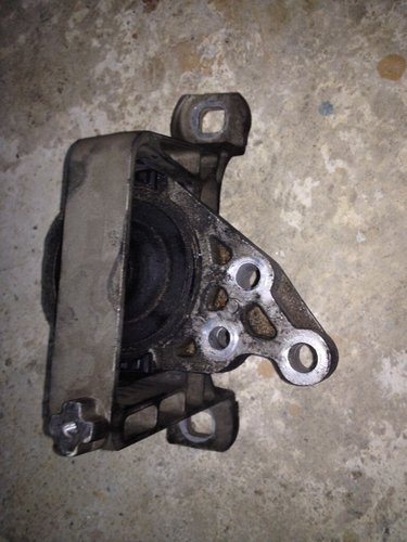

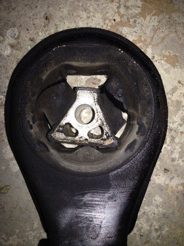

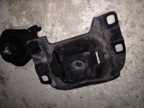

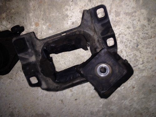

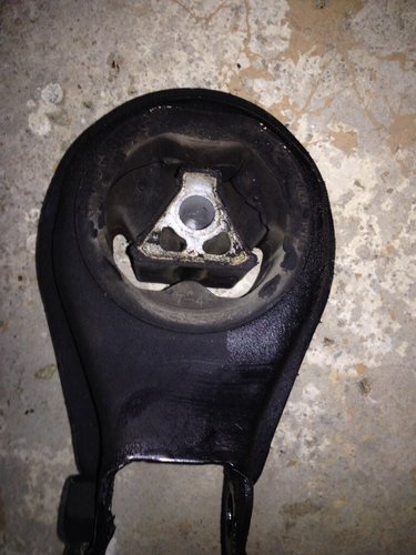

Finally getting a chance to post this update.
Ended up going with generic mounts, as I was unable to source oem Mazda ones outside S/Sales and they needed replacing urgently.
Turns out all 3 were totally shot. As you would imagine, the car rides MUCH better now :)
Rear
Closer inspection
Right
Closer
Left
It seems that the rear and left side mounts for the 1.6L are the same as those found on the 2.0L. The right side mount (the large oil filled one) is different. Note this is just from my observations of pics and vids I've seen online - I can't confirm in person.
If I need to change them again though I'll order those 2 online from Mazda dealer.

You are correct, only the right side mount is different between the 1.6l and 2.0l, I can confirm this. A idea too would be to invest in the Whiteline rear mount poly inserts. That particular mount when it gets weak puts strain on the right side mount in particular. It is supposed to be softer than the one Corksport sells and should not make a tremendous amount of vibration inside your car. It may be your best bet to reinforce that mount particularly as it is aftermarket.

Thanks for confirming the mount similarities - good to know.
