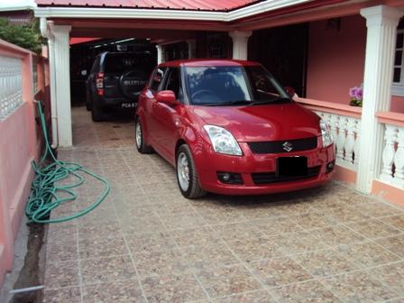

*KRONIK* - u got a swift sport?!
i was thinking about trading my CK2 for one...
Posts: 9319
Re: Project Restore hope!!!
Postby *KRONIK* » September 29th, 2010, 1:29 pm
triniangie wrote:*KRONIK* - u got a swift sport?!
not a sport..
just a regular 1.5...auto...
