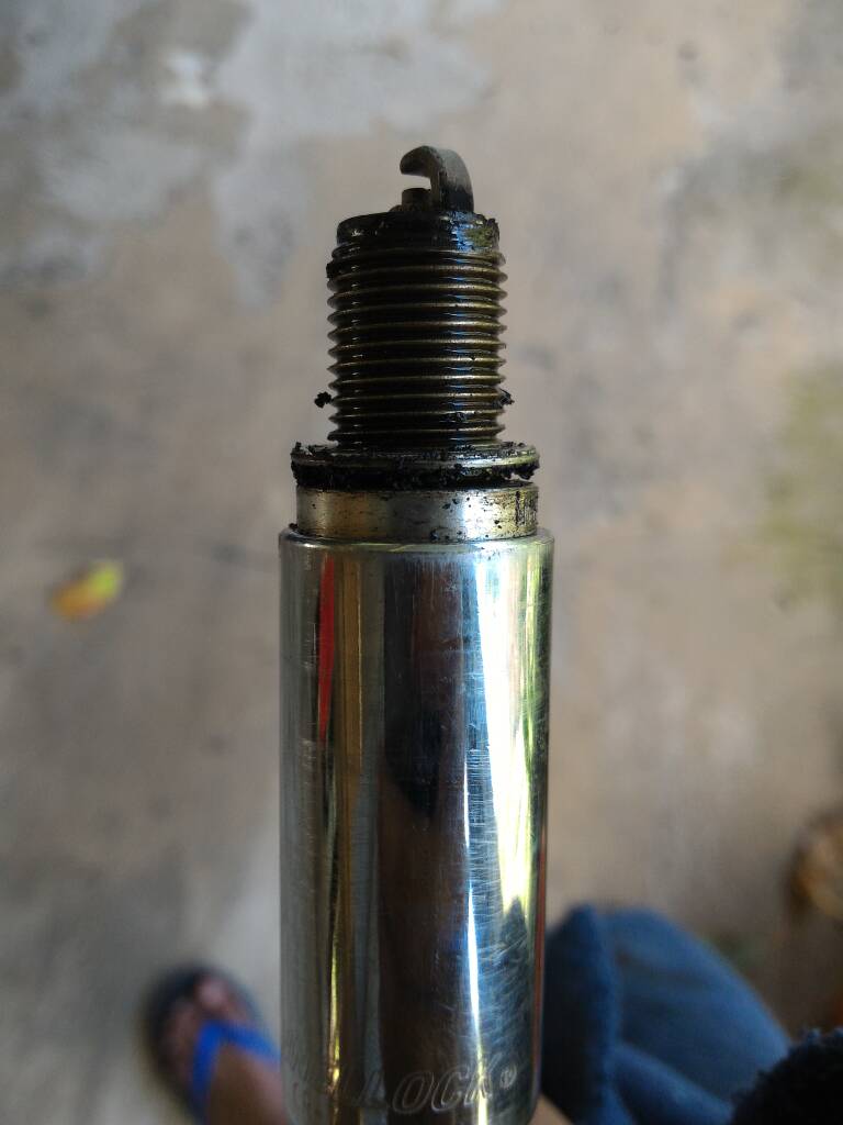

Jade_Inc.

Thks it's how my spark plugs look, my car isn't smoking at all... any ideas what could cause this?

Jade_Inc. wrote:Thks it's how my spark plugs look, my car isn't smoking at all... any ideas what could cause this?
Sparkplug seals on the valve cover leaking
Jade_Inc.
Posts: 713
Re: The Official CS Lancer Thread!
Postby Jade_Inc. » September 30th, 2015, 4:11 am
Just the threads are getting oil, the spark plug wire is dry. Not a drop of oil
Postby wagonrunner » September 30th, 2015, 10:41 pm
Jade_Inc. wrote:Just the threads are getting oil, the spark plug wire is dry. Not a drop of oil
which is usually as a result of exactly what cinco said.

Postby Jade_Inc. » September 30th, 2015, 11:12 pm
Mechanic chittin I up den...I bought the plug seals and carried it for him to change and he told me the seals is not the problem. He said my rings maybe going....
Postby wagonrunner » September 30th, 2015, 11:46 pm
between you and your mech.
Some have had your symptoms before, and we shared our solution.
Im sure the seals are cheaper to replace (can even DIY) than the rings, but it is up to you.

Postby Jade_Inc. » October 2nd, 2015, 5:40 am
I wud do it myself but is there any gasket or rubbers that wud need changing when I open the top cover?
Edit.
Seals isn't the problem.. just opened the cover and the seals are perfect

Jade_Inc. wrote:I wud do it myself but is there any gasket or rubbers that wud need changing when I open the top cover?
Edit.
I replaced recently my seals looked very good but they were still leaking. used the new seal and no problem since
Jade_Inc.

Postby Jade_Inc. » October 4th, 2015, 8:22 am
Edit.
Ok bro, I already bought them so I would try it. Thanks
