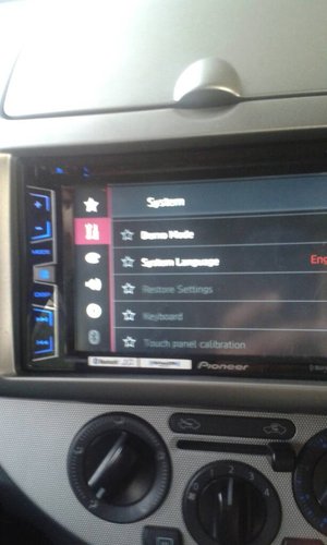

Open the setting menu, go to system, the icon looks like a spanner and screwdriver. Click on restore settings, you'll get a prompt, click on restore.
When it restarts you have the option for network or standard.
Re: Help--accessing network mode in 2700BS
Postby X_Factor » December 10th, 2015, 4:51 pm
the thing is, that option is not available for me to select
i am not sure, but i think maybe the parking brake tingy has to be wired in or a bypass

Postby X_Factor » December 10th, 2015, 5:24 pm
pic.....I am gettin frustrated with this as its causing delays in finishing the install
