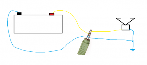

You want to get as much power as possible, to do this you must bypass the amplifier completely
but dont hook it up directly to the battery, dais just dotish

ruffneck_12 wrote:You want to get as much power as possible, to do this you must bypass the amplifier completely
:o:grin::grin::grin::grin:
Great now everyone knows you are a complete jack@ss
