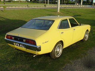

yeah ah hear yuh....you could squeeze the condenser in dey yuh know....but all dem tie straps go have to come into play. But yes....you can mount the condensor in the trunk and all once it getting ventilation...watch the L200 Vans and the H100s ...many other cars and vans have them just nea the battery below the tray. Once you have a dedicated fan blowin thru it. And Betsy doh have cold breeze...is the yellow one...
