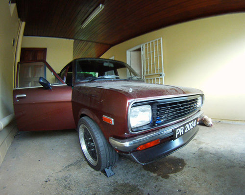

Hey guys, I am thinking of selling my Datsun 1200 Sedan.
(insert cries from tuners and other not to sell)
As many of you know, I have put allot of money and time into this car, it's a work in progress, but it's at a stage where it drives great and is allot of fun, some minor stuff is needed to be done. Would be great for the DIY'er, hobbiest or someone looking for a fun car to solodex etc.. who ever buys it I will let you know all the stuff I had planned for it and websites that you can get allot of info. i have a guy locally who has a 1200 scrapping now that you van get parts for, and the fellas that race the fish van and the other 1200's bring in cars to scrap that you can get body parts (there are alos BRAND new body parts - doors, fenders, trunks etc) selling on ebay for the 1200's)
1973 Datsun B110 1200 Sunny Sedan
Body is in sound condition, no rot, the roof has some rust, but the last body job (which is about 4-5 years old) has not bubbled the roof, but from the inside you can see some rust as there is NO interior to speak of.. some minor rust spots in trunk, but in really great condition for a 37 year old car, chassis/floor etc is in excellent condition. Since I have had it it has never been left in the rain, it has spend over a year and half parked in a covered garage wrapped in a car cover (included with sale :P), in fact only got driven in the rain once since I had it. Car has all the nickle, fenders are like new, brand new front bumper, front lip spoiler etc etc.. minor cuts made to the front fenders for wheel clearance... lights, wipers etc work etc..
CA18DET engine with 5 Speed Gearbox w/ Subaru VF turbo ( CA18 engine number on certified copy)
Aeromotive Fuel Pressure Regulator
Mishimoto Front Mount Intercooler
Custom 2.5" polished Aluminium Piping
HKS Air Filter
Trunk Mounted Battery (NEW)
Custom 3 core Copper Radiator
GReddy 1.3 bar Radiator Cap
Custom Overflow Bottle
S13 Brake Booster
S13 Front Lower Control Arms
S13 Custom Adjustable Front Castor Rods
S13 11" Single Piston Front Brakes
Custom S13/B110 Steering Setup
S13 Tein HR Front Coilovers (Height and 16 way Damper/Rebound Adjustable)
S13 Tein Adjustable Camber Plates
Pathfinder H233b Welded Diff (10" diff)
Rear Disk brakes with single piston callipers.
Custom adjustable 4 link Rear suspension
Leaf springs & Koni shocks rear
15x6.5 Load Racing Wheels (Bridgeston Potenza RE tires (4) & (2) Continental Tires - spare wheels etc)
JAZZ 12 Gallon Plastic Fuel Cell with Safety Foam and Fuel level sender
Walbro 255lph HP Fuel Pump

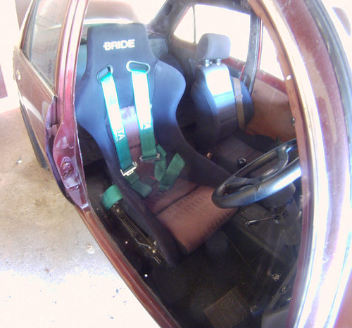

Bride Racing Seat (fixed)
Takata 4 point Safety Harness
more that I am forgetting
LOTS of spare parts (diff, suspension, brakes etc)
also have ZG Fender Flares to put on.. buyer will get those with the sale.
