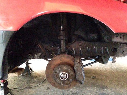

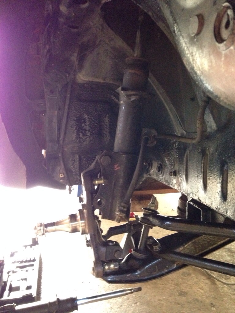

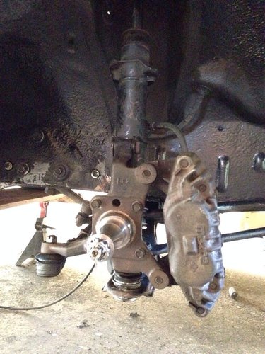

Fc 2nd gen 5 lug big brake swap. 11" x 1" rotors 4 piston calipers done
T3 camber plates, coilover kit and top hats should be here by next Monday

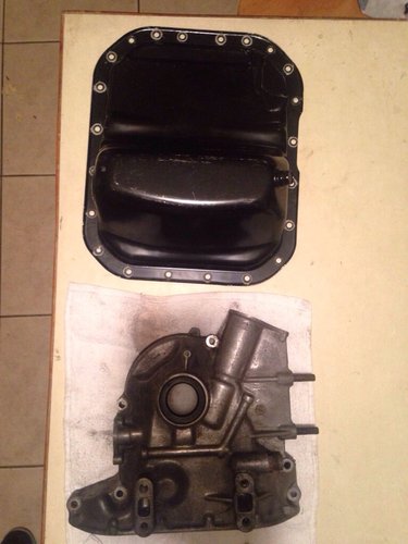

Engine is going by Sean Ready in a couple weeks to get prepped to install, new oil pan, oil pickup and front cover install, remove all emissions stuff, and remove oil meter pump etc also getting him to flip the exhaust manifold so the turbo can clear the steering box... also going to ask him to inspect the engine and replace any seals that he sees may be replacing. VERY fair price was quoted and looking forward to sending it and more so getting it back and installing... wanna start this baby up for my birthday in a few weeks :D

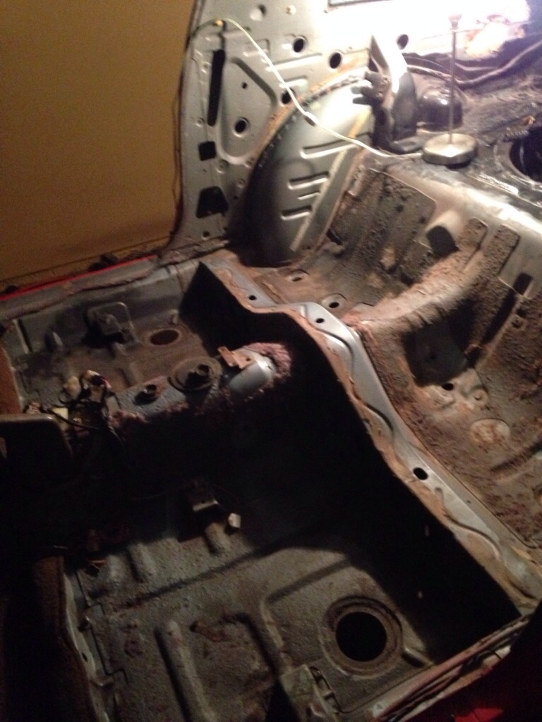

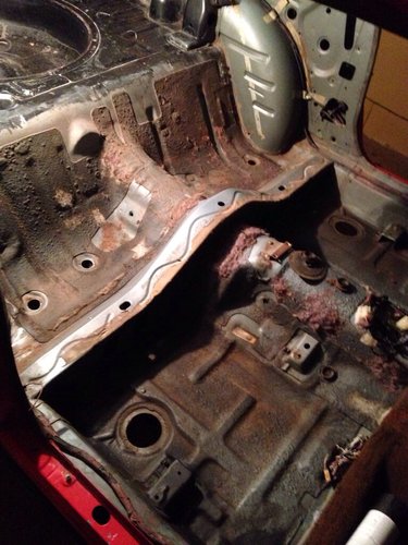

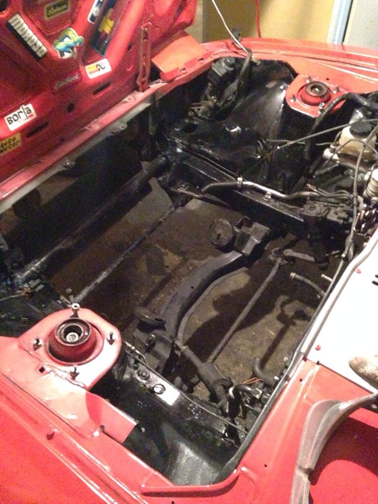

Cleaned out the interior floor with a wire brush (lots of fluff from sound deadening) and used some rust remover on the surface rust and then sprayed all the clean spots and seams with rust repellant by rustoleum (just a temp preventative measure till paint)
All that brown stuff is the left over from the sound insulation that was glues down. Didn't take much pics after (too dark and moved onto engine bay) But will post a few tomorrow.

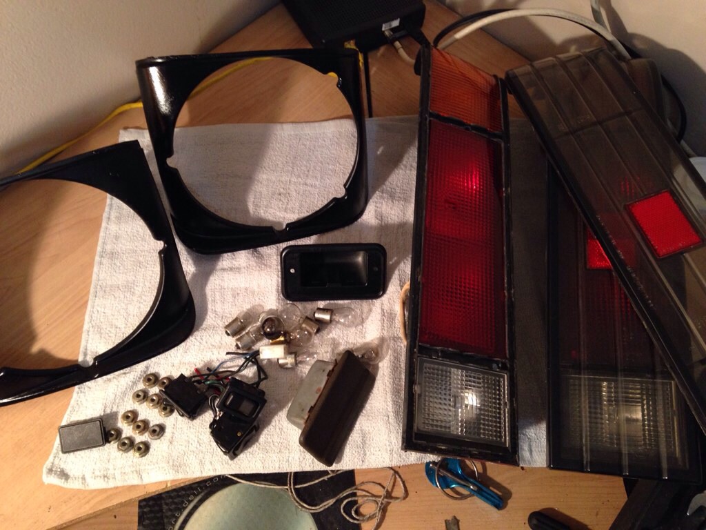

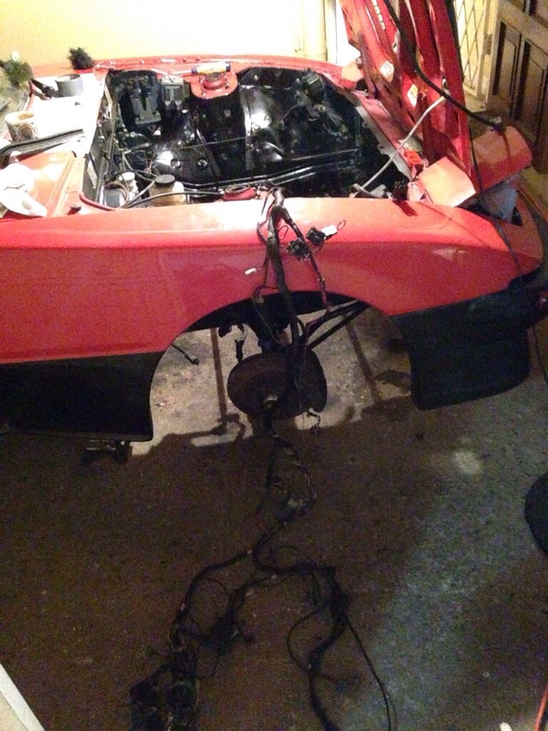

Pulled the engine bay harness out this evening and cleaned the engine bay. I want to extend the harness and tuck it where possible. Just a few pics
Took apart the rear light and cleaned them, replacing all the bulbs etc. Painted the headlights buckets. Waiting for new headlights to arrive.

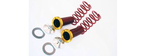

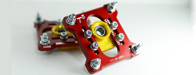

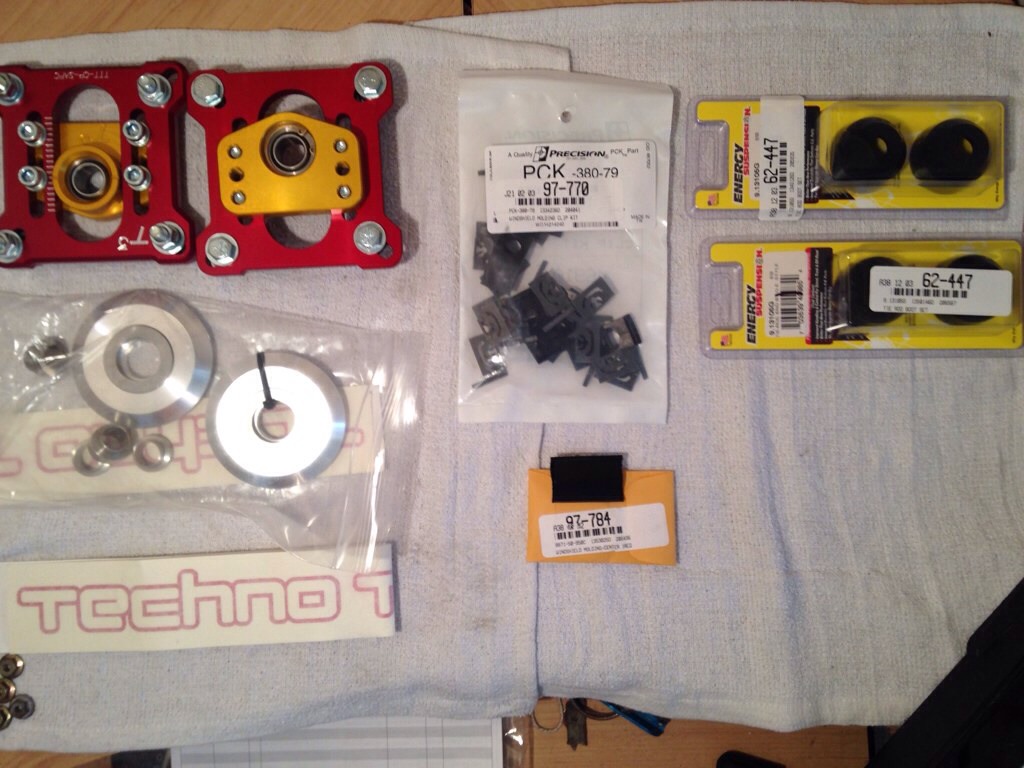

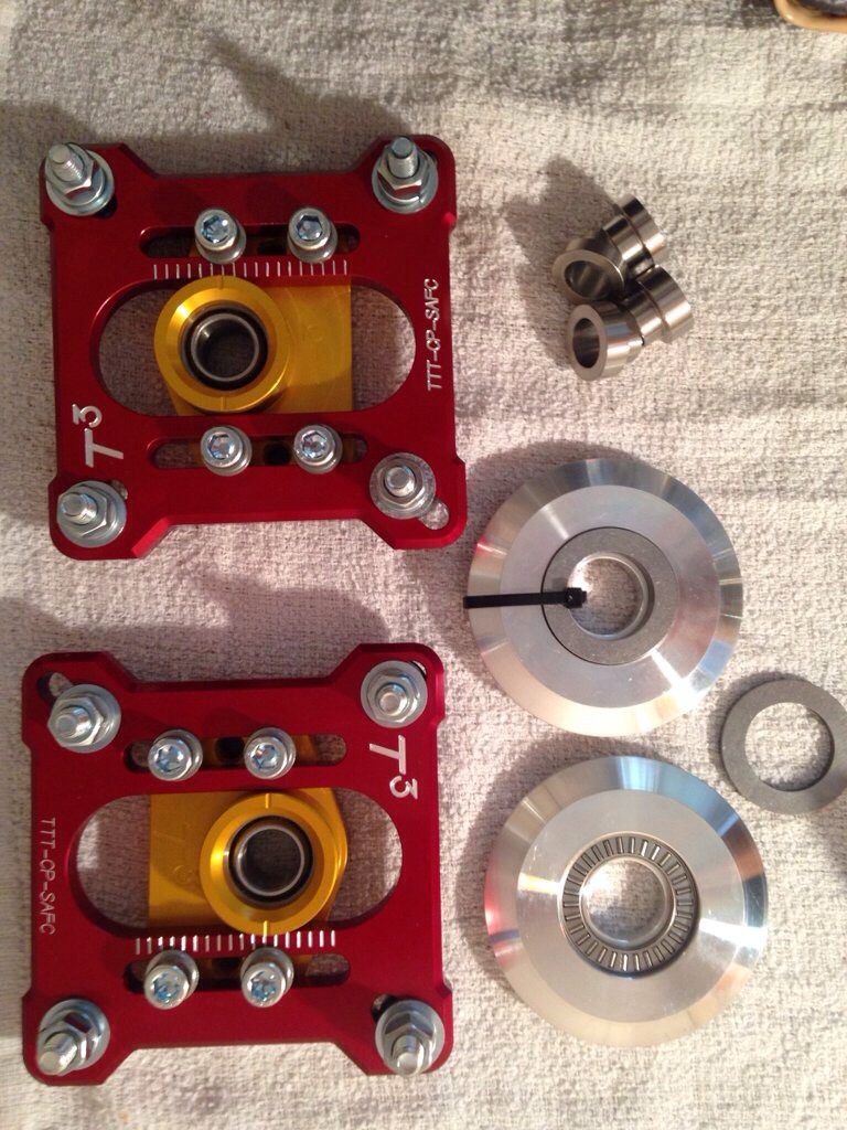

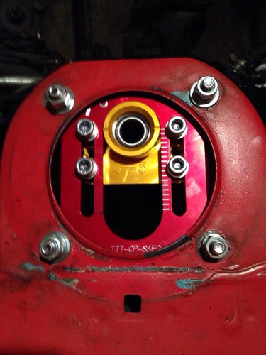

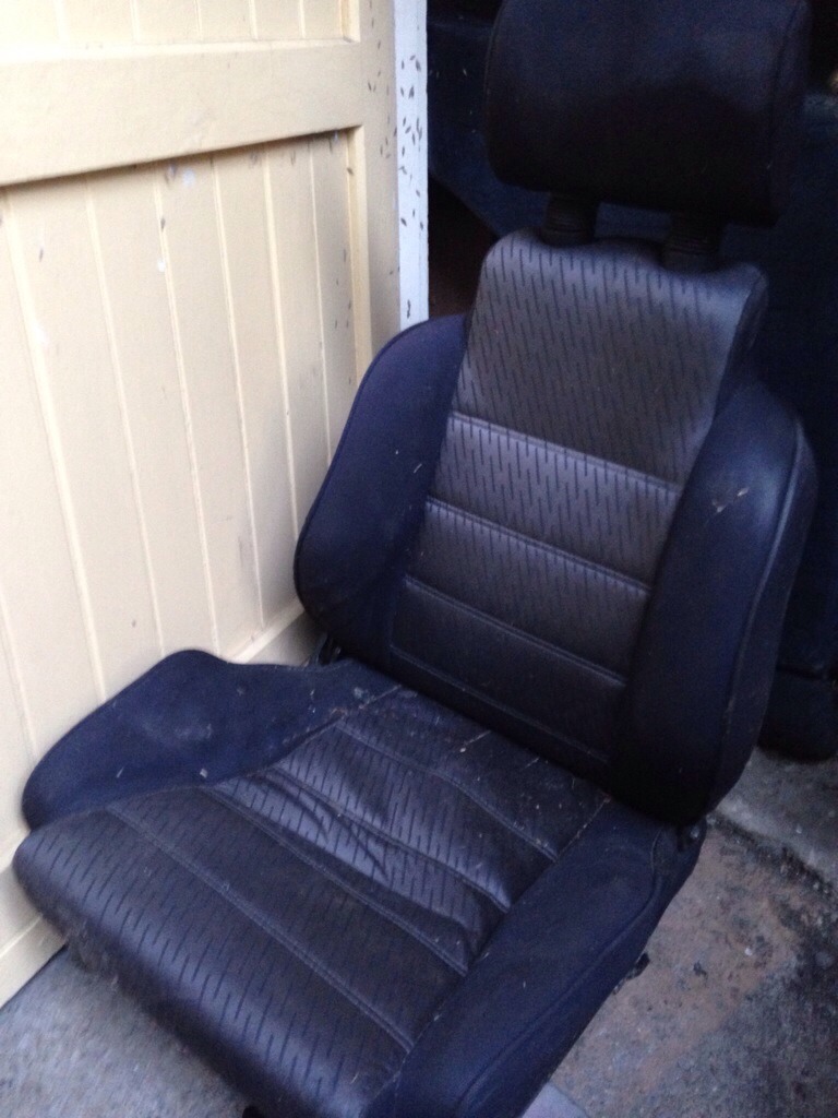

So today got the techno toy tuning camber plates and top hats.
Waiting in new struts and the coilover sleeves.
Also got all the windscreen and trim clips, and poly tie rod bushings all from Black Dragon Motorsports. If you own a rx7 or 240zx that place is a lifesaver.
You know you're a car guy (or getting old) when you have a room full of parts you forgot about :lol:

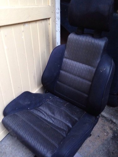

Found a bucket(ish) seat that bolts in, (kinda)

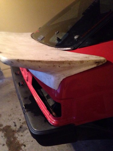

And found a whale tail :lol: that I totally forgot I bought about 10 years ago when I had my Silvia. I think it came off a 180sx. But it fits the first gen almost perfect :D
Also found lots of inter cooler pipes and a turbo xs blow off valve. I just laughed when I washed the wing off to test fit it and it slipped on.. Will get some better pix but no one was around then to take a pic then

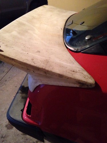

Bezman
Posts: 6635
Re: My First Generation RX7 Project
Postby Bezman » March 27th, 2014, 11:12 pm
Another angle of the ridiculous wing
moti
Posts: 4812
Location: looking for Perry!
Postby moti » March 28th, 2014, 10:08 am
Once it looks good keep it, might actually "blend" in with the body kit.

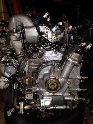

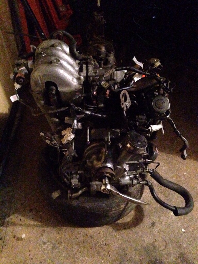

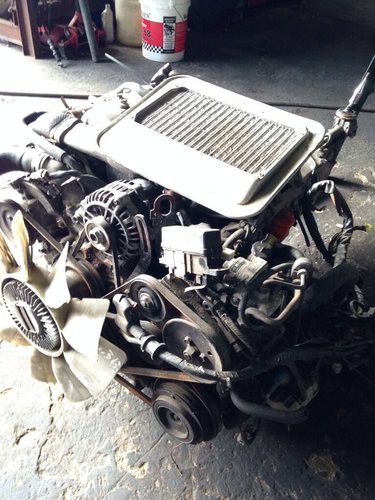

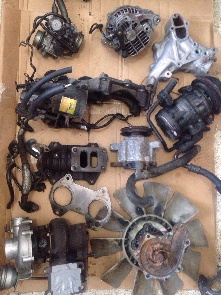

Started scrapping down the engine. Took off alternator, water pump, fan, air con compressor and power steering.. Just making it easier and cleaner for the engine prep and oil pan/front cover swap. I realized I need a new water pump, seals in the old one gone.. Need a new pressure sensor (mine is broken).
Can't decide if in going to take off the oil metering pump (oil squirters that live the engine via the intake), auxiliary air valve (opens 5/6th intake ports), air pump (emissions) and bypass air control valve (adjust idle for aircon). They don't sap much power but they make the engine look so clean when removed, but are sometimes a problem when removed with stock ecu. Engine starting to look something like a rota

Postby Zorak » March 31st, 2014, 10:27 pm
Haha! Man, that wing just seems like divine intervention! So crazy that you just had it lying around. It's definitely gonna fit in with that beefy kit you have.

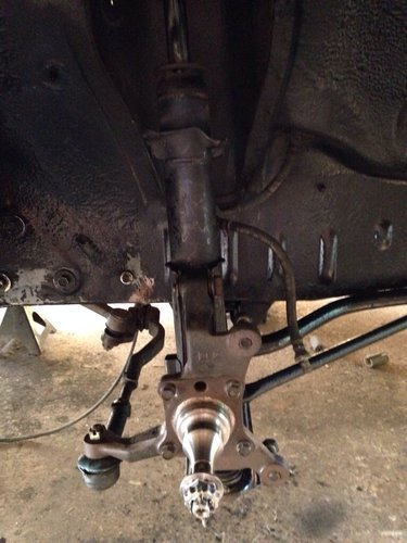

Hey Razkal, yes I did consider the FC subframe and rack etc but as mentioned earlier in the thread didn't want to drill the frame rails etc.
I have my front suspension pretty much figured out and am only missing a few pieces. Been speaking with TechnoToyTuning allot about some adjustable lower control arms that will work with my setup to allow more camber and castor. As per the bushing etc. I already beat ya to the punch ;) Thanks for the offer though :D
Zorak. No. that wing is a no... Pics make it look allot better than in reality. It's not a match. But a good inspiration to get the CORRECT wing ;)

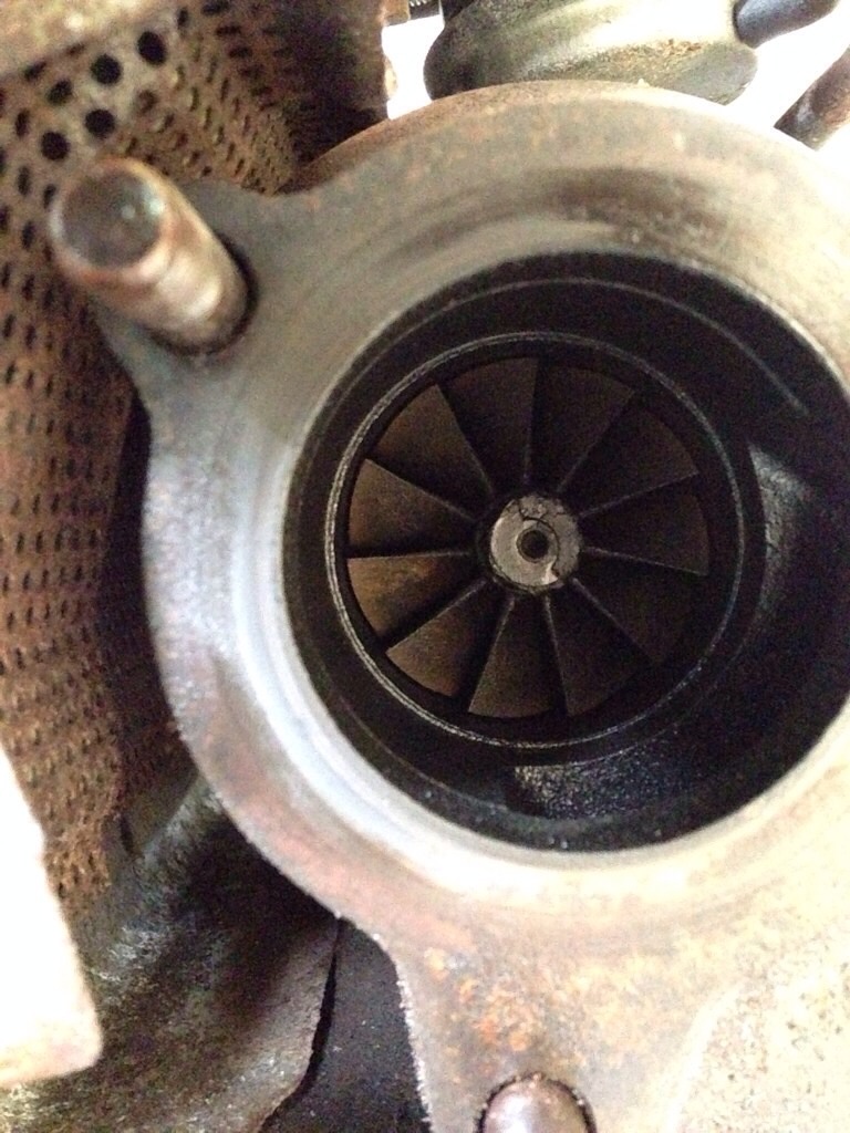

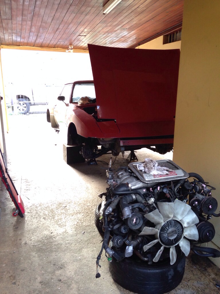

Took the day off yesterday to go surfing in bago and today was back at it hard. Tore down the turbo/manifold, tested my ideas of flipping the manifold as to move the turbo further forward and clear the steering box and it's all great except for two turbo flange holes that need to be enlarged/elongated for it to bolt up. Small thing.
Turbo looked great though. No excessive oil for a rotary. Here it is on the engine still.
Amazing how much all that crap weighs. I'm thinking maybe 100lbs or more!!
Also started labeling the entire harness and wires coming out the ECU. Found a wiring diagram for first gen to second gen so may be allot easier than I thought to wire up and then have an expert come check it for me and start the car.
Having all the factory service manuals and wiring diagrams makes this so much easier also. Have the fc wiring diagram open on my iPad and mazda wiring diagram in my binder next to me. Makes checking the wiring diagram I found online for accuracy a breeze.
Made allot of progress but was dark, left my phone upstairs to blank out the world and I was a filthy mess and didn't take any pics.
I have also had enough of the squatting, stooping and sitting on speaker boxes and old chairs etc. I'm buying an engine stand this week as I plan on taking the gearbox off the engine and don't want the dam thing rolling all over the place like a top :p

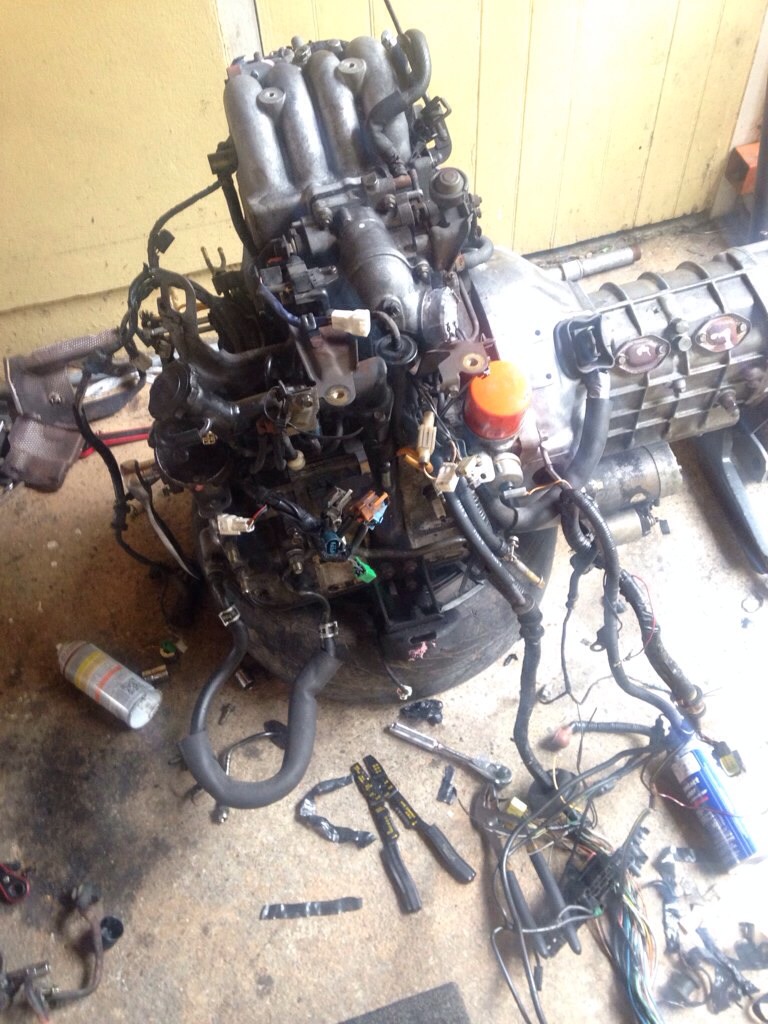

As per the apex seals. Some may notice that I have a ratchet on the front pully, I took out the plugs and turned over the engine a few times and checked the apex seals, pressed them and they all were moving and had spring in them, they look great, some carbon build up on the rotors, but gonna try the water steam trick courtesy pineapple racing (hook up gallon of water via vacuum lines while flooring it to keep it running) once the engine gets started, works amazeballz apparently to clean engines/rotors without damaging seals.
I also took off the exhaust manifold and turned the engine over for some time listening for galloping/missing and it sounded good. Will make a vid and upload as I want opinions. Also looked at the seals Better and didn't see any broken pieces nor scuffs on the rotors. (Phew, for now)
I must admit. Watching the engine like this I am very temped to get some 9.4:1 NA S5 rotors and go carbd. Ditch all that wiring and extra shiit and just do a nice clean simple engine. But as I have all this crap already and it looks great, let's give it a go!
