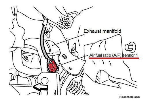

Air fuel ratio sensor might be the problem

Is the A/F sensor connected to the fuel gauge somehow?

Obtain by Nissan have a look
Re: Tiida fuel gauge problem
Postby Ted_v2 » February 6th, 2015, 7:39 pm
STUPES.
no sir thats not for that purpose.
thats something totally different.
what happen to most of you all, is you over fill gas and cause the unit to get damage/bend.

So can the a/f sensor be changed?
