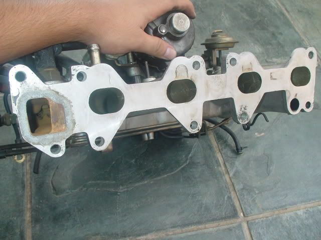

godsson wrote:hey tuners im having a problem with my engine....its spitting water from the cabeurator and i drained out the gas tank and fulled up with super gas....i still got the spitting problem again..i took of the cabeurator and water sprayed out the manifold with a pressure...wats goin on???
If your intake manifold looks like this, that port on the left is for coolant to flow through the intake manifold. If there's a crack in the manifold or a breach in the gasket, it'll allow coolant to get in and shoot out the carb port. Check that first.

i hav a question, dat diaphragm showin in the picture, what is its purpose?? i have an L20ET engine and it ave one looking like that, there is also a line from the exhaust to the underside of it.

I've no clue. Exhaust gas recirculation maybe? Many Lancers and older Corollas have that carb and I never found out what that was for.
Years ago when I changed the engine in my old 'rolla hatch, the mechanic said those carbs were troublesome , so I kept my old one.
Maybe one of our resident mechanics can enlighten us *shrugs*

hmm, buh this engine is fuel injected, turbocharged, it has 2 vaccum lines to it, the exhaust line is jus to the underside of the diaphragm, it doesn't hav a blow off valve, but i see a thing screwd onto the manifold side which i was told was a 'buffer' . :?: :?: :?:
