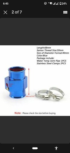

Cleanest install is get a top hose adapter and screw the unit for the gauge in there.
Measure your internal diameter of your top hose to determine size adapter you need.

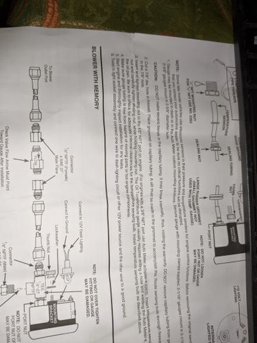

this is a pic of the instruction

Wow you are bringing hot water into the vehicle!
The rad adapter has a npt fitting you can tap into.

The unit is like this.

I am fairly certain that this mechanical temperature gauge is using a calibrated capillary tube. It works more like a tire pressure pencil gauge - the actuator pops out as the temperature rises.
The problem with these is routing the copper tube to the vehicle instrument panel. It's not too difficult on a tractor or a boat but a wired gauge is much simpler for a pickup or a passenger car.
