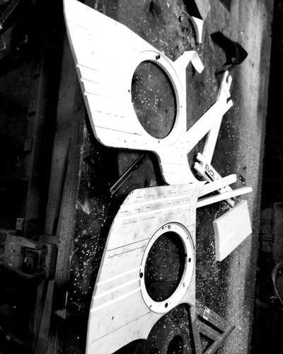

6 1/2" coaxial dls ur series in a bmw e30 kick panel
No tuning and centre image is defined but shifted slightly to the left with very good stereo separation
As with speakers in the kick stage height is a little low just around dash level
Panels custom made and bolted to the frame of the car freq response goes down to around 45hz with cabin gain
Excuse the black mess on the carpet remnants of a cheaper quality sound damping materiel that was used on the original kick panel.
This is my personal vehicle

So this is what is planned for the 3 way "front stage"ImageImageImageImageImageImageImageImageImageImage
Firewall
Posts: 1287
Joined: October 29th, 2006, 8:15 am
Re: Essque
Postby Firewall » March 3rd, 2020, 7:26 pm
Tried some listening and aiming tests a few days ago. The only thing that I came up with so far is that I prefer on axis rather than off axis.
The 2 on axis points that I tried aiming at were
- the map light.
- the point where the center of the vehicle and the headrest perpendicular line intersects.
Preliminary listening suggests that I prefer point 1 more.

Great stuff, ensure when you fabbing the pillars make them most compact as possible as to not obscure your sight through the windscreen. Especially right side.
Firewall
Posts: 1287
Re: Essque
Postby Firewall » March 5th, 2020, 7:02 am
SR wrote:How are your centre images?
Center image seems more defined when aimed at point 1
kavaninho wrote:Great stuff, ensure when you fabbing the pillars make them most compact as possible as to not obscure your sight through the windscreen. Especially right side.
Definitely a concern for me. The speakers are a bit bigger than expected. Good looking out!

Try raising the mounting height of the dash speakers worst case it needs to clear the gauge cluster.
Firewall
Posts: 1287
Re: Essque
Postby Firewall » March 5th, 2020, 7:46 pm
SR wrote:Try raising the mounting height of the dash speakers worst case it needs to clear the gauge cluster.
Based on some reading, i am thinking about bringing them more forward, in which case they will definitely need raising to clear the gauge cluster.
Its this thread mainly that makes me want to bring the midrange away from the windshield. (seriously, take a read)
https://www.diymobileaudio.com/threads/on-axis-vs-off-axis.136438/
All of this is why I suggest mounting tweeters on axis, using a small mid between a 6 and a tweeter, and keeping speakers away from the junction of the dash, side window and windshield. Tweeters are not as big a problem as midrange speakers in that location
The flip side to this is to mount it as close to the windshield as possible
What this is doing is getting the drivers as physically close as possible to the prominent reflecting boundaries. What this does is it pushes the comb filtering as high up in frequency range as possible, and everything below that is mostly unaffected by the early reflections (in relation to the distance to said reflecting surface to X frequencies wavelength)
The plan is for the tweeters to be on axis in the sail panel, but this thread makes a case for everything in the a-pillar:
https://www.diymobileaudio.com/threads/2016-subaru-crosstrek-audiofrog-helix-zapco-illusion-resonix.425137/
The reason i believe that keeping them in the same plane vertically, isnt as simple as they can act like a single speaker and arrive at your ears at the same time. If the speakers are in different locations you can still use delays to make the DIRECT response in time. The problem is there is no way to control the on and off axis response of a speaker separately. Since the horizontal plane is more important in relation to dispersion, we want them vertically and close so not only the on axis response is in time/phase, but so is the off axis/reflected response. We have noticed some seriously good improvements when doing relatively simple systems with this method.
I will have to do some more testing for fitment before I decide.
