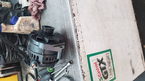

SR
Chief Cook & Instigator
Posts: 13958
Re: 08 Toyota Fielder Idle Rpm / Charging "Issues"
Postby SR » February 23rd, 2019, 8:11 am
200 amp alt with internal regulator and underdrive pulley for the 1nze
For sale as i am downgrading the system in the vehicle and there is no need for it
