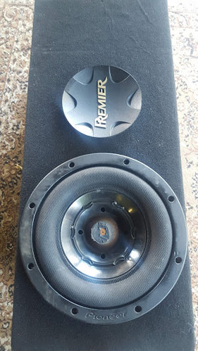

Would like to know what i can use to re-stick my sub?
Its a Pioneer Premier TS-W3002SPL.
heard it making noise an realized the outer cone started to detach, i carefully removed it guessing from taking licks over all the years..lol
everything else intact an original in sub and it was never repaired before.
see pics below

better u take it to a reputable speaker repair guy who shud have proper CA glue & let him stick it ...

E6000 for the dustcap and surround. If your spiders came loose, you'll need either CA glue or locktite 5 minute epoxy. The spider landing (basket) needs to be cleaned of any prior adhesives or paint btw.
(note: If your softparts are already loose, you may have already started to damage the coil)

L'Audi wrote:E6000 for the dustcap and surround. If your spiders came loose, you'll need either CA glue or locktite 5 minute epoxy. The spider landing (basket) needs to be cleaned of any prior adhesives or paint btw.
This.
Otherwise regular crazy glue will hold it good enough. Make sure all surfaces are glued otherwise it will rattle and annoy the hell out of you.
If this came loose I'd check the other glued joints as well though
