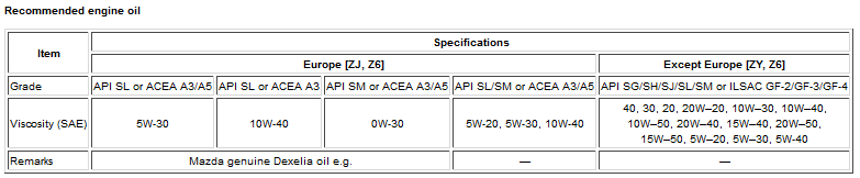

Re: Mazda 2012 Axela Engine oil?
Postby Big Z » November 27th, 2016, 11:07 pm
Linky
Mazda ZY Oil.png (7.18 KiB) Viewed 6181 times

Strugglerzinc
Posts: 4043
Postby Strugglerzinc » November 28th, 2016, 7:25 am
Big Z wrote:eLinky
Exactly
