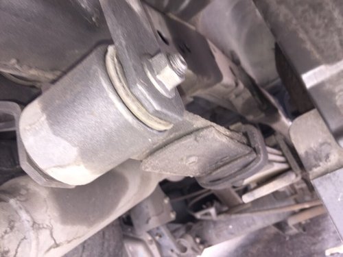

Outer

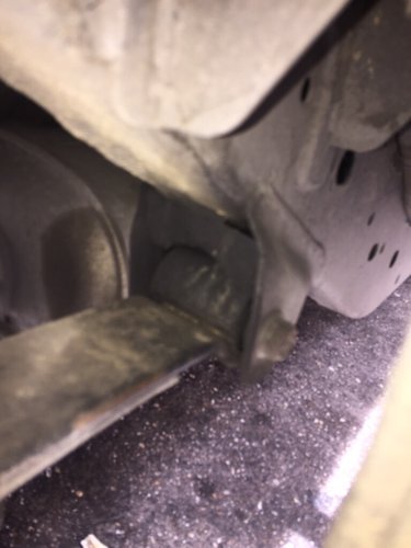

Postby joeman » May 23rd, 2015, 10:27 am
Saw this on my d40
