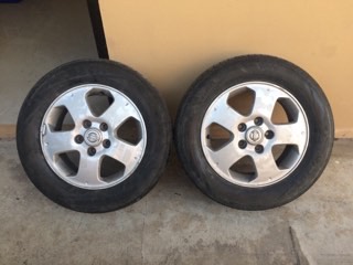

Good day if Any of you interested I have these original Serena rims for sale with 90%tyres make an offer

Anyone knows the hole spacing or the Serena rims ???
5x114? Or not

Postby d34 » December 29th, 2015, 11:32 pm
Bolt pattern 5x114.3
Diameter: 15.0'' - 16.0''
Width (inches): 5.5 - 6
Offset (mm): 45.
d34
Posts: 44
Joined: June 12th, 2005, 9:30 pm
Location: Sando ~ Curepe
Re: Nissan Serena C25 Club
Postby d34 » December 29th, 2015, 11:38 pm
Wheel General Info
The ranges of possible values for tires and rims of Nissan Serena
Tires for Nissan Serena
Diameters: 14.0'' - 16.0''
Width (mm): 185 - 205
Tire aspect ratio (%): 60 - 70
Smallest tire size: 185/70R14
Largest tire size: 195/60R16
Rims for Nissan Serena
Diameter: 14.0'' - 16.0'';
Width (inches): 5 - 6;
Offset (mm): 30 - 45.
Bolt pattern 4x114.3
Diameter: 14.0'';
Width (inches): 5.5 - 6;
