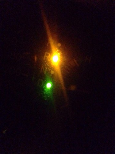

Would the engine check light illuminate? Because everything looks fine on my instrument panel besides the PRND2L area
JayyXXII
Posts: 60
Joined: September 11th, 2012, 12:15 am
Re: NZE Corolla Transmission HELP
Postby JayyXXII » June 15th, 2015, 10:16 am
R and D illuminated at the same time

Prob solved... Solenoids
