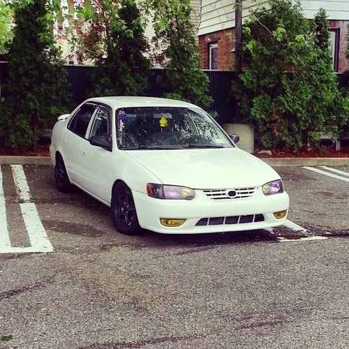

Whats up people I'm new b to this. I have a 1999 toyota corolla e110 aka toyota carib. I'm doing research for putting the 3sgte 4th gen in my car. Currently I have a 1zzfe motor. Any help would be appreciated ..
pics of my car
