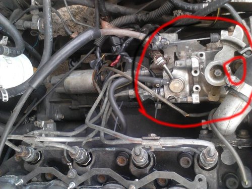

Its in the fuel pump [attachment=-1]uploadfromtaptalk1401136434709.jpg[/attachment]
Big circle is the pump
Small circle is where the the strainer is
Yea I do have the old model L200 but they all use tye saE 4D56 engine!
