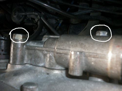

Open the bonnet and look to the back of the intake manifold you'll see the IACV. Using your 12mm spanner or ratchet and socket remove the bolts circled in white. Be sure to put the shorter bolt on the top and the longer one underneath.
P1020510 (Custom).JPG (55.83 KiB) Viewed 2775 times

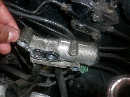

Now you remove the two 12mm bolt you left with this. To remove the connections use your bird beak pliers and hand. Grip the pliers to the hose and turn with other hand. If you are having a hard time turning the valve use silicone spray to loosen the hose. The green clip unsnaps easily by hand.
P1020512 (Custom).JPG (57.37 KiB) Viewed 2775 times

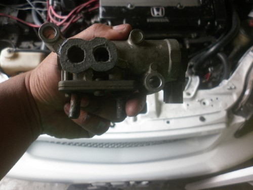

Time to clean the valve using your carb cleaner. I used the Amsoil power foam because it loosen and dissolves the deposits quickly. Repeat process as necessary untill you remove most of the gunk.
P1010674 (Custom).JPG (56.19 KiB) Viewed 2775 times

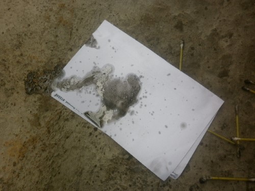

While the valve is drying it's time to make a template of the "8" to prevent any more vacuum leaks.
P1010675 (Custom).JPG (43.94 KiB) Viewed 2775 times

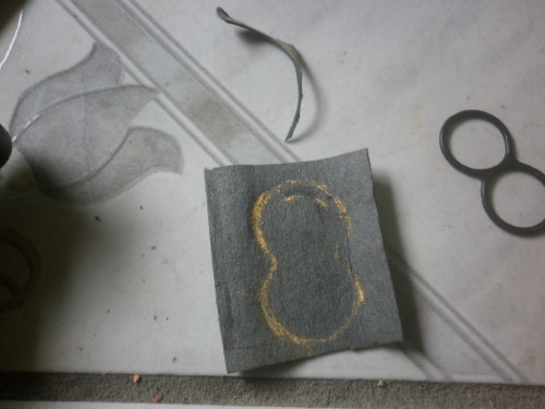

Take your chalk or water colours and stroke evenly and lightly around the "8". Be carefull not to get any inside the valve holes. Now it can go on the gasket paper.
P1010676 (Custom).JPG (50.93 KiB) Viewed 2775 times

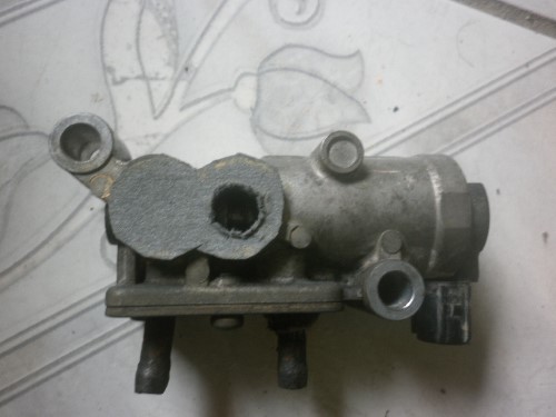

Using the gasket maker around the "8" carefully rest the gasket paper template on the valve and press moderately. This ensures both bonds well. Take yuh blade and swirl through the gasket paper. Invert the valve to prevent paper from entering the holes.
P1010680 (Custom).JPG (43.87 KiB) Viewed 2775 times

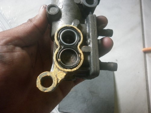

Final product. :D
P1010681 (Custom).JPG (49.94 KiB) Viewed 2775 times
