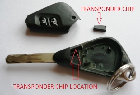

Ahaaaaaa....problem solved....apparently when I opened the key the transponder chip fell out between the seats. I found it under the driver seat....so the N&M guy was scamming me for sure because he opened the key also and should know what the chip looks like and if it was missing...
One thing I learned is the transponder chip does not work with the battery and is separate from the lock/unlock feature of the key...see picture...
Google really helped me here because I knew what to look for from the picture...
Thanks tuners for all the help...this was an experience...
Cost to solve problem $0.00....just time in reading....

Yeah if u flip the key over it would fall right out...didn't even notice it....
I think it may fit more snug in a new key....we'll glad that's over....
