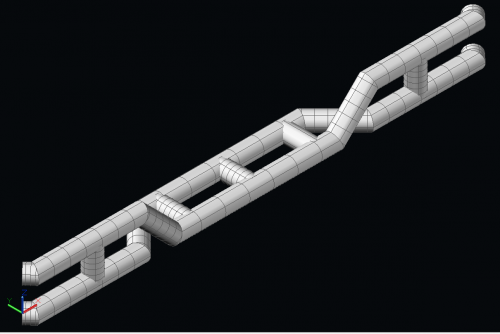

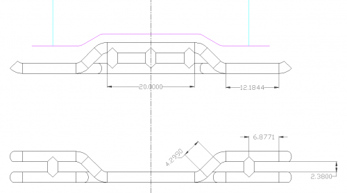

Hey guys! Way going thru my portable hdd and just came across some drawings I did for a rear bumper for my IMV Hilux a few years ago. Never got a chance to build it. Got a job abroad and had to sell the vehicle :cry:
Figured I'd post it so hopefully someone can use it. The design was to use 2" sch 40 pipe and fittings.
The material list is:
10' - 2" sch 40 pipe
12 - 2" 45 deg elbows.
Was planning to use 1/4" or 3/16" thread plate for the step area and 3/8" x 4" flats to make the brackets.
Had already purchased a tow hitch (2") to weld under the step area. :oops:
Well like I said. hopefully somebody can make use of it! Post some pics if you do.
