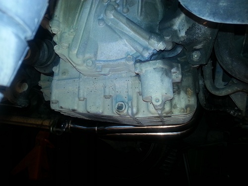

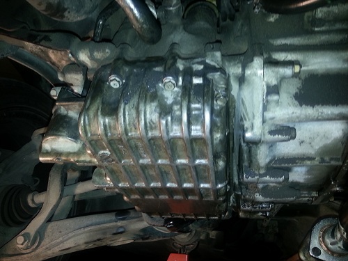

Tranny right hand side of the vehicle

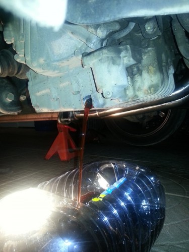

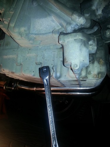

1/2 '' power handle to screw out the drain bolt to drain the CVT fluid

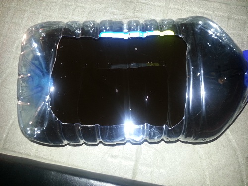

CVT fluid draining
Dirty oil

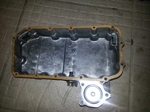

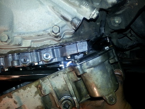

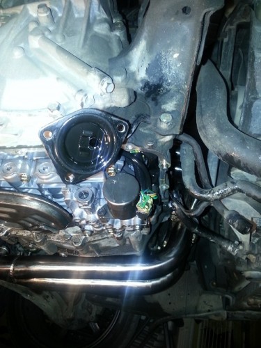

it has about 12 10 bolts around the housing of the tranny crank case remove them , and gently pry the pan down

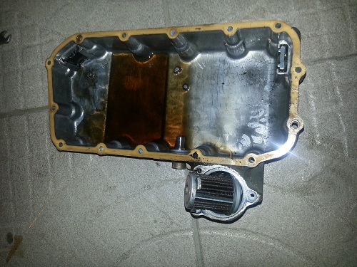

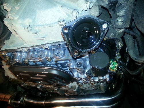

as shown the cylindrical case is the filter housing , above it has 3 10 bolts carefully remove the bolts
as you remove the bolts the bottom housing will drop and you will see the filter top becareful not to burst the O ring on top of the filter
gently pry out the filter as shown
then take carb spray and clean the filter and housing

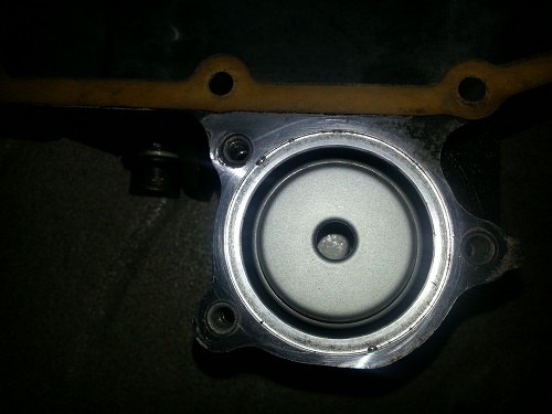

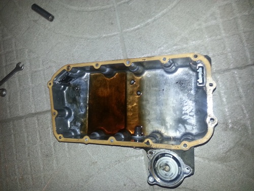

what the bottom of the tranny looks like
clean filter and housing
replace bottom housing , be careful with the housing 10 bolts not to put to muc torque on them to pop it .
refill the tranny with 5 qrts to full
run the car for about 15 mins drive then return , drain the oil and replace it with new fluid and your tranny should work like new .....

and i think the drain bolt is a 3/8, not 1/2.

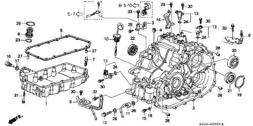

Just changed this filter along with the two seals and gasket this week,and car drives times better than before.For those who need part numbers for these items it's as follows:-
PACKING, OIL PAN (Oil Pan Gasket) 21814-P4V-000
FILTER COMP - 25450-P4V-013
O-RING, 37.7X3.5 (ARAI) - 91305-PN4-003
O-RING, 49.3X2.4 - 91331-P4V-003
All these part numbers taken from japanese catalogue on cd.Once u learn how to operate this catalogue,you can find exact part number for each and every part.Been using it the last couple of years and each part correct each and every time.
