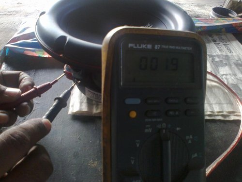

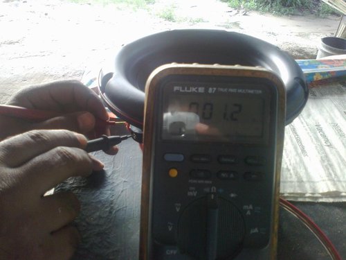

Postby zorced » November 28th, 2011, 6:50 pm
just as suspected. Dunno how, but the voice coils gone.
1.9 on one coil, 1.2 on the other

Postby 3stagevtec » November 29th, 2011, 12:26 am
lol, those look more like dual 2ohm coils!

Re: Sub problem(s)! [Pics of Multimeter Readings]
Postby silent_riot » November 29th, 2011, 11:34 am
1) Nice multimeter
2) Sub seems to be dual 2 - your amp may not have been stable into that impedance and went into protect
3) There could be a mechanical defect of the sub causing the smell and noises.
